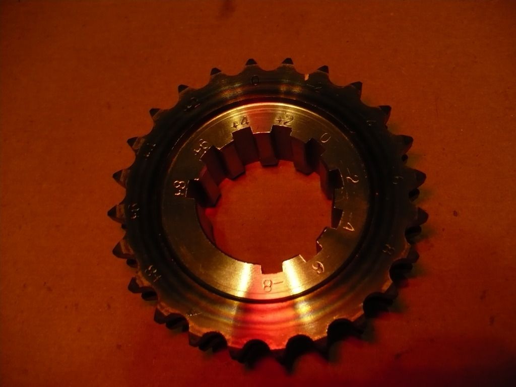

You can buy a timing set with degree options in the lower gear. I have a set of Harland-Sharp rockers (500 miles on them but warranteed for life) if your interested.
