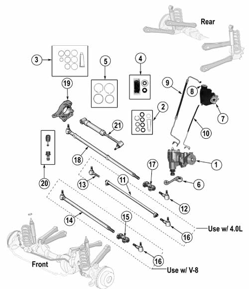

My 97 XJ needs all new steering parts. I've read that you can swap in ZJ V8 steering parts - some parts, but not all of them. :looney:
1. Which parts numbered below are to be replaced with ZJ parts? (Answer by number for convenience!)
2. For a 1997 XJ, what year(s) Grand Cherokee parts should I get?
So instead of #22A in the XJ steering diagram above, I use #14, 15 and 16 in the ZJ diagram below. Direct bolt-in to the XJ steering. Same year (97 ZJ). Correct?
I was looking at the Crown upgrade (which is basically just OE spec plus a ZJ tie rod) but I've read elsewhere that their tie rod sleeves and hardware last as long as milk left out of the fridge.
Figure I'll order all new MOOG parts (with the ZJ substitutes) and that'll fit the bill. Thanks for the help.
