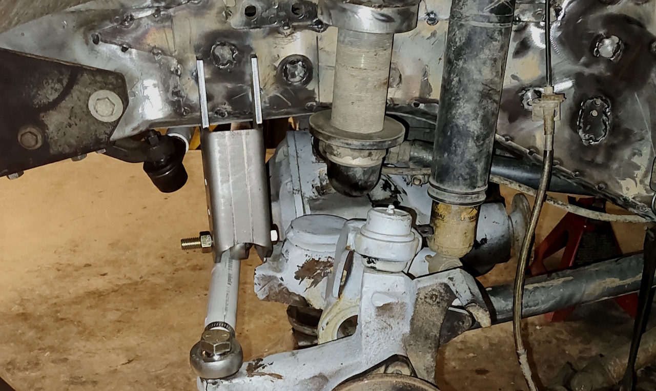

SFR frame-side bracket doesn't have any outboarding and I would have to rebuild it to add any. The Ruff Stuff bracket should be get more length, and is vertically adjustable, and I'm currently running a TJ/LJ pitman arm (flat) so I have a few inches of movement on that end of the drag link too. I expect I will have to discard/replace at least 1-2 components so that might be one of them, but I think it gets me furthest to success

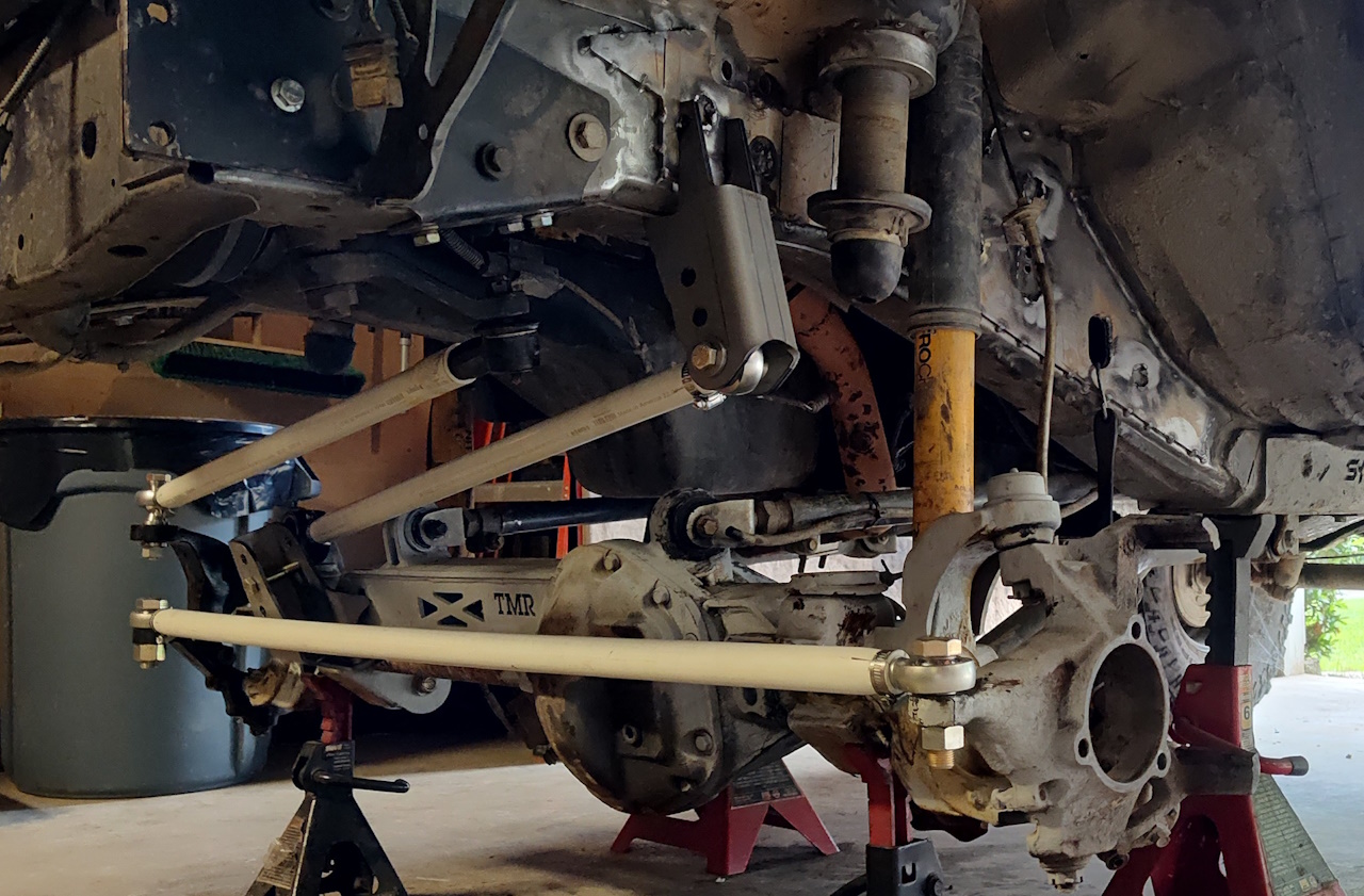

Finally got started on this
TMR truss and Artec gussets were welded onto the axle by a nearby shop, then I removed the stock brackets, tacked the JCR front stiffeners in place (will finish later), and reinstalled the axle housing to the control arms to test travel.
The tie-rod rubs the coil buckets and the diff at full turn, and needs to come forward a bit. I need to replace those heims with off-sets.

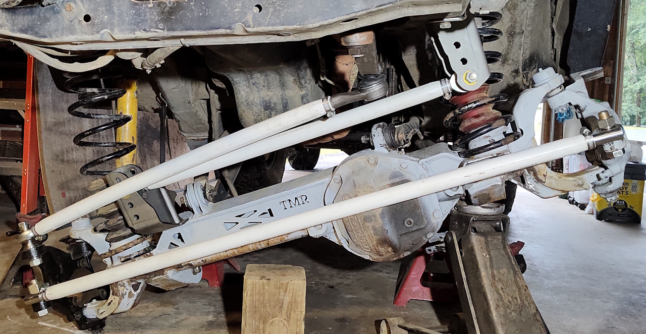

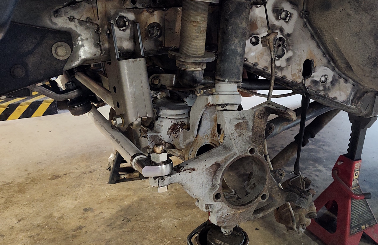

I had to go OTK on the steering arm to get the parallel angles (more-or-less) working. Otherwise the axle-side trackbar bracket would have to go under the coil bucket, exposed and non-adjustable. OTK puts the drag link close to the oil pan, but I checked full stuff and it doesn't contact until very close, the bumpstops and the compressed coil spring will stop it before it makes contact (I hope). I am running a YJ pitman arm which is flatter than the stock arm, so I can drop the arm a couple of inches if needed.

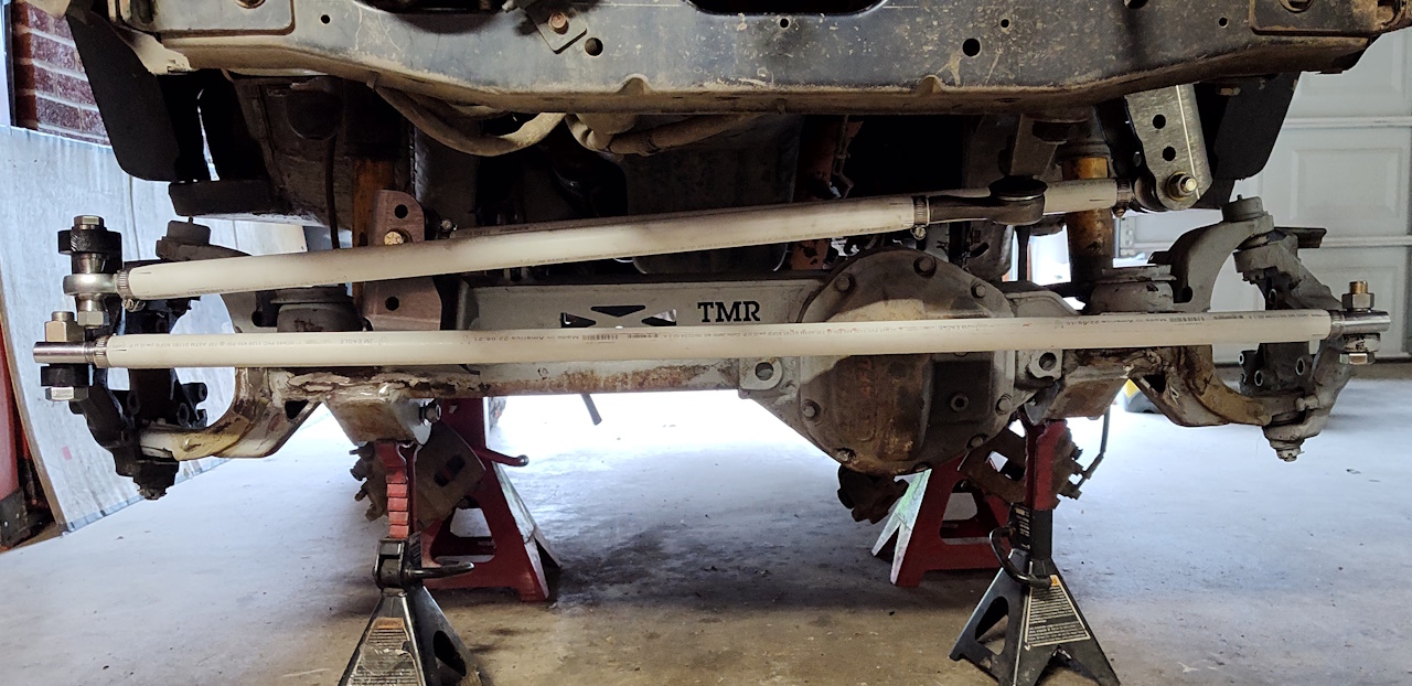

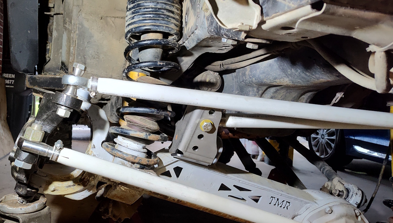

With the track-bar set to the same length as the drag link, the axle-side bracket sits right in front of the passenger coil bucket, about 4-inches too long. The frame-side bracket hits the driver coil bucket and needs to come forward about an inch. I have room to bring the frame-side bracket out and forward without hitting the tire, but probably only move it a little and deal with any remaining bump steer (if it becomes annoying I will fab my own frame-side bracket). I am going to cut the axle bracket and mount it to the face of the truss to give more vertical adjustment so that I can compensate angle changes in the drag link if needed to clear the oil pan.
The knuckle clears the tire with the 3.75 backspacing but it's really close, might add .25" ring spacers to get me through.
