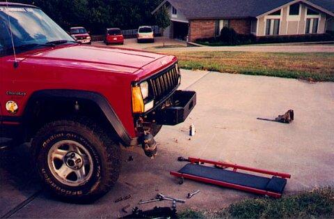

I would weld it in like this...to the bottom of the frame mounts and the front...

JDComptonXJ said:
HOLY BIG ASS Winch plate! Where did you get that thing? Did you make it?
I may be wrong, but that looks alot like the winch tray for the C4x4 Fabrication bumper, minus the outer shell. At least that what mine looks like without the shell/cover dealy on.
yep.. c4x4...
