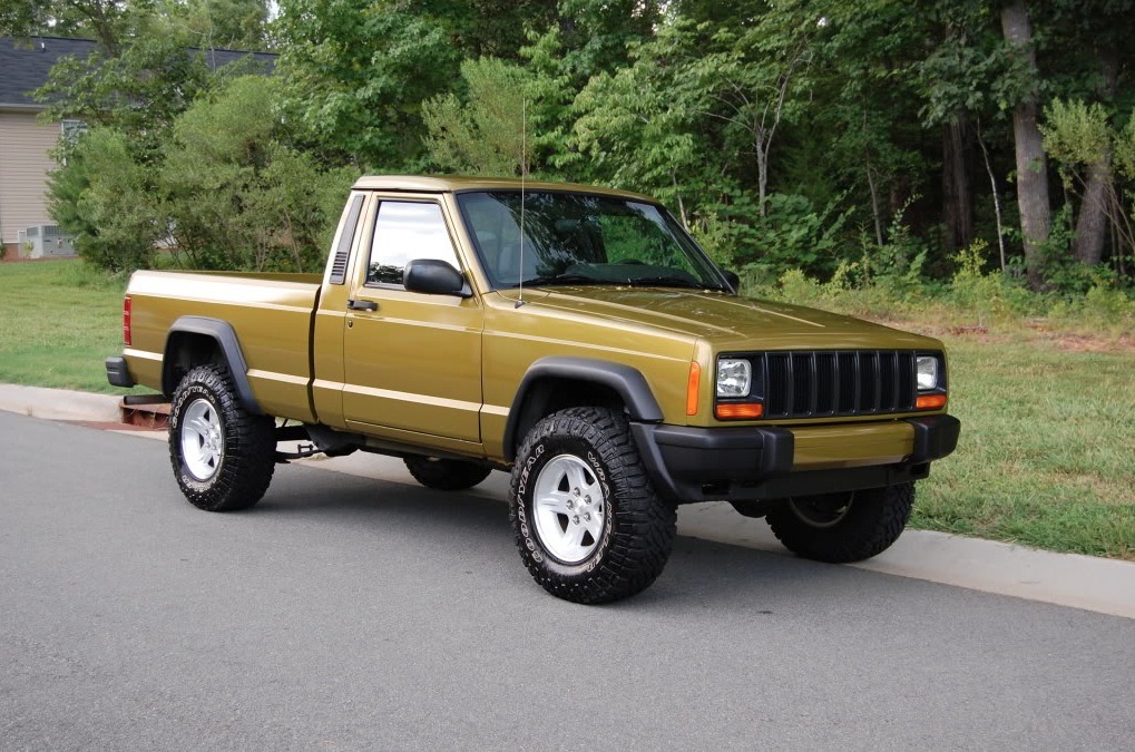

Something like this:
Nice
Yea, that truck looks awesome, even under the Gerber Creamed Peas paint job. Baja fenders on the front would look sweet........
