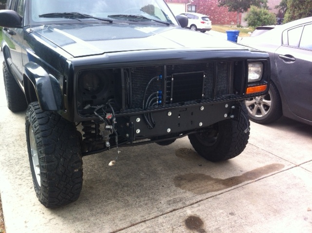

Thanks for the info. What brand of cooler did you go with?
Derale 6-row dual-circuit:
