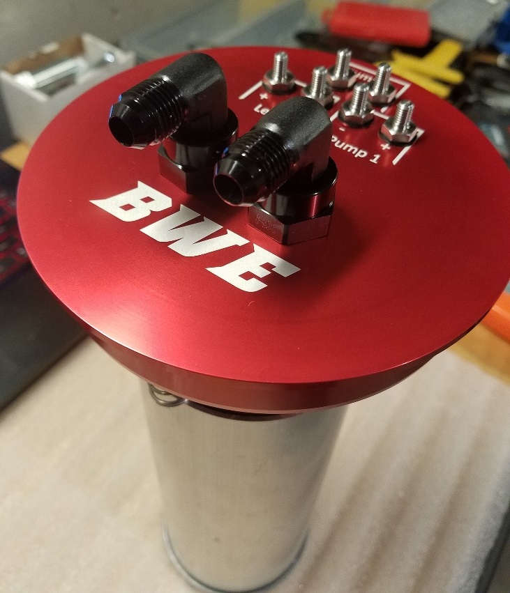

This is the fuel pump that I installed when I did the ZJ tank swap, reusing my XJ sending unit. This pump was selected to support the fuel needs of my upcoming 4.6 stroker install.
