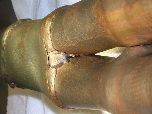

XJING said:
My nephew works for Borla, and he told me they haven't gotten a return on a header for any jeep product with a crack for as long as he has been there (about three years) some that were obvoiusly in accidents and crushed, but not heat or a vibration related crack. So have the guy send in the one you saw. They have a lifetime replacement warrenty.
Show him these pictures:
Cracked Borla header pics
The only reason they aren't getting this one back is I can't find the receipt.
Bones :skull1:
Bones :skull1:
Well I returned two of them in a single year and finally sold my last "new replacement" that was still in the box and went with a clifford long-tube set-up.
