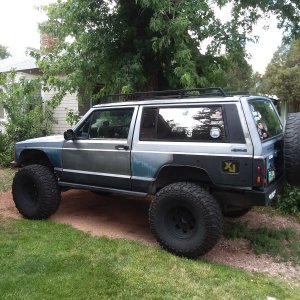

I've had a 90 since 92. I live in the Springs. It has always run rich, the only time it didn't pass back in the day, was when it needed a new catalytic converter. Even now when it is a 4.1, 11-1 ported HO head, bored T-body, Hesco cam and water pump, Mopar header and 2.5" exhaust some of the plugs show rich. The electronics are all stock, and relatively new. It does have a high altitude CPS which advances the timing a couple of degrees. It never ran that cool stock, but was acceptable later on with a flowcooler water pump, and now with the Hesco it runs cool. It's a big heavy beast on 35's. I don't know if the HA CPS is still available, if you do junk yards, the sensor is not in the middle of the attachment like most.
