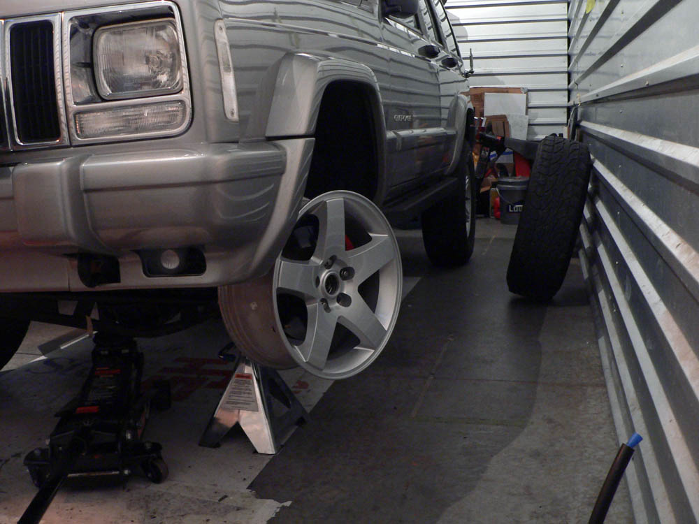

If you want aluminum wheels the Dodge Charger/Chrysler 300/Dodger Magnum have wheels that will work. Don't know the back spacing, but close to stock as they stick about 1/4" more than stock. IIRC a few people have also used the steel wheels off them as well.
17s:
