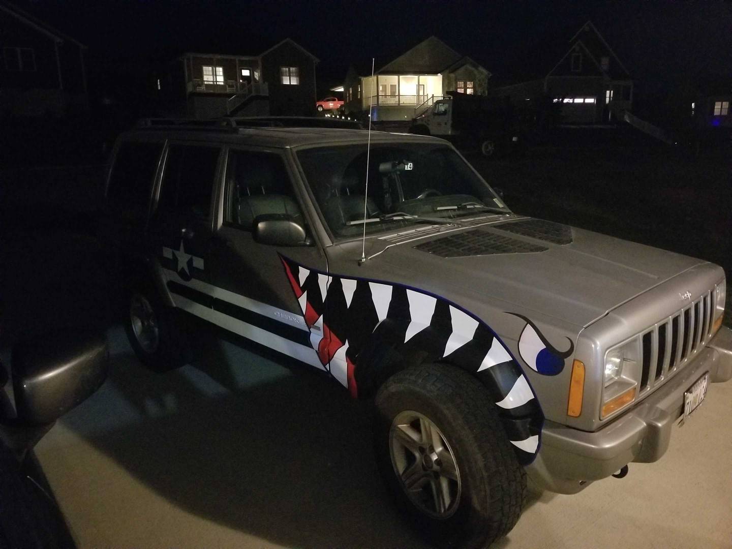

Sorry for the nighttime photo, but finished this up the other day. Ode to the WW2 generation...and it looks cool.
