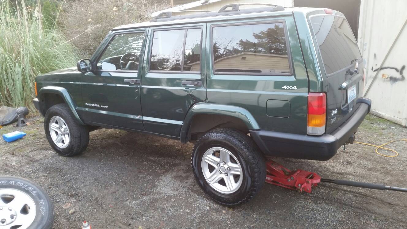

Put a new fuel filter and passenger power window motor in the green 1996 stock daily driver.
Much better. Still waiting on tires. Replaced out back
-leaf springs
-bushings
-bump stops
-shocks
-deleted swaybar
Also replaced my busted drivers seat with a rugged ridge one. Still on the fence about how I feel about. I thought the color would be closer to tan based on online photos but oh well.

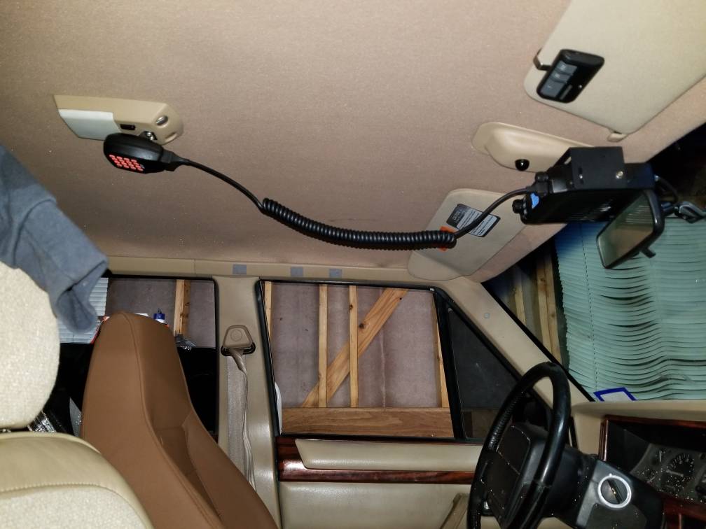

Did a drain and fill on the AW4. Pulled the front brakes apart because the front passenger side was sticking badly. Replaced plugs, wires and cap/rotor, put an OEM oil pressure sensor in, and moved the HAM radio from my Mazda to the Jeep.
