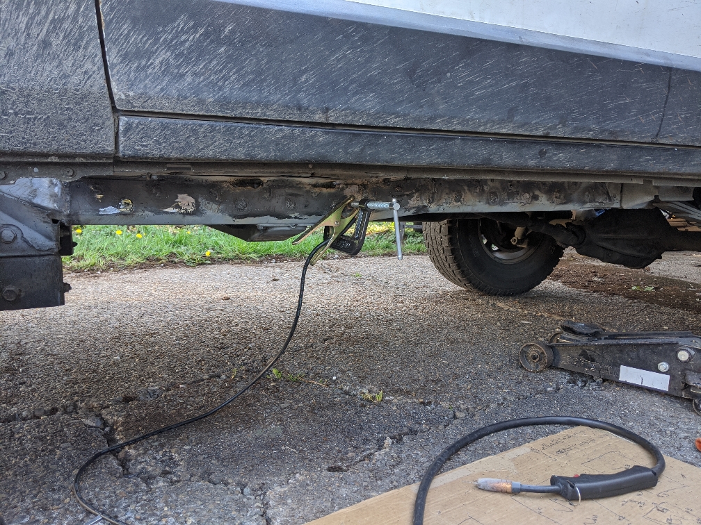

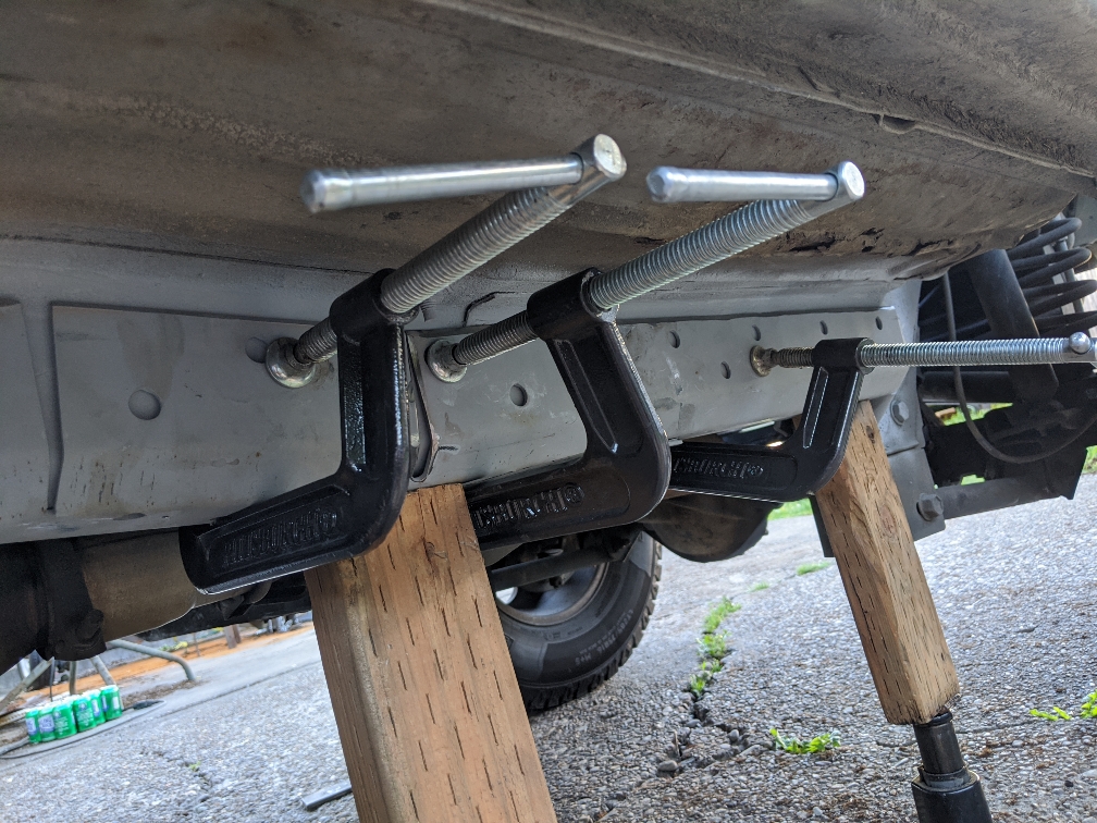

Started installing my HD Off Road frame stiffiners.

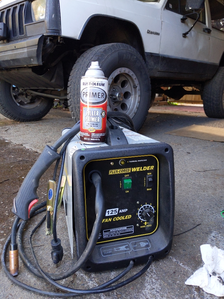

Nice. I see you painted them before welding them on. What paint did you use? It was said that weld through primer was difficult to weld through. Was that your experience?
Not the OP, but I've used the weld through primer once (can't remember the name - was a copper color) and it was fine. And I've read about others using it without issues a few times.

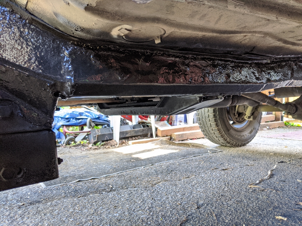

Finally finished the mid sections! Re-primed then and got the first layer of under coating on.
I used some Rust-Oleum primer and then wire brushed it off where I welded. I was mostly worried about the back side and didn't want to leave it bare metal.

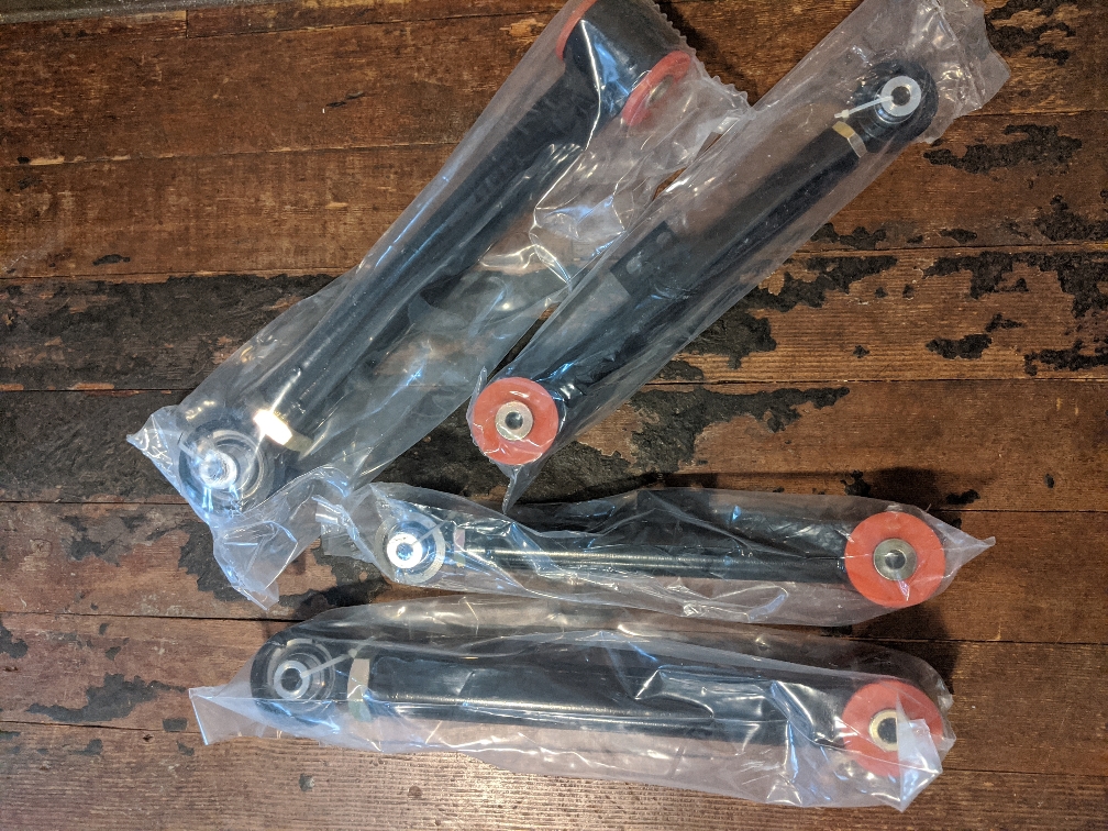

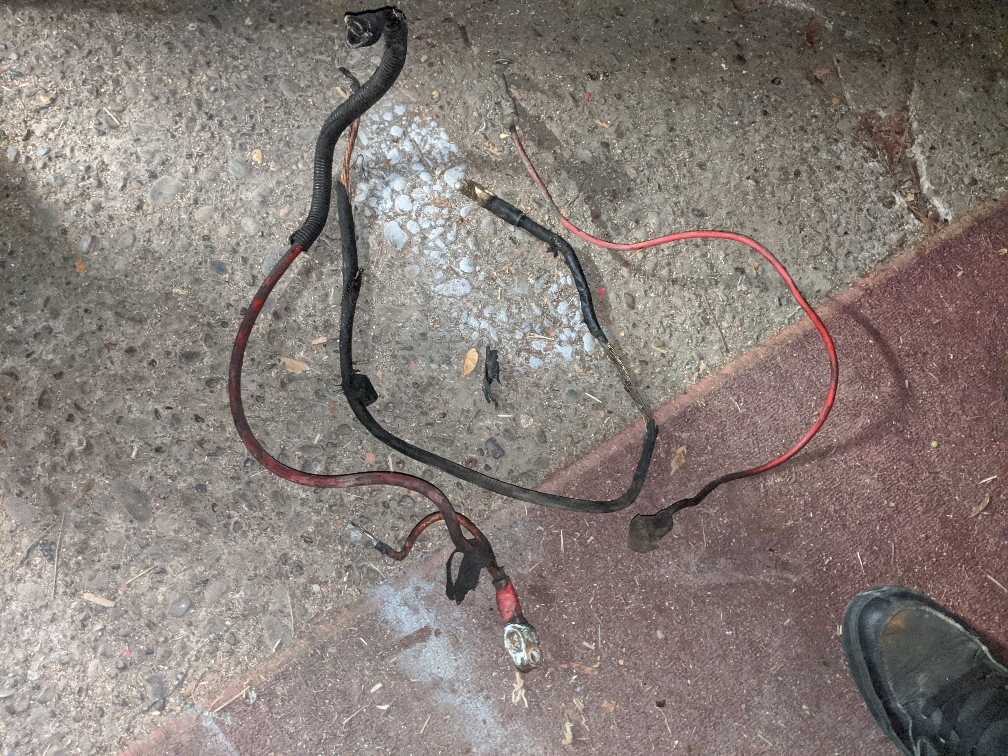

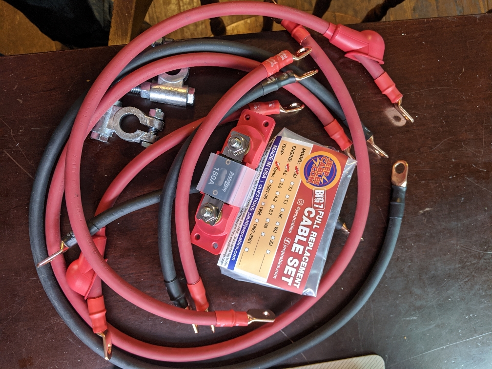

Installed The Big 7 from Jeep cables.

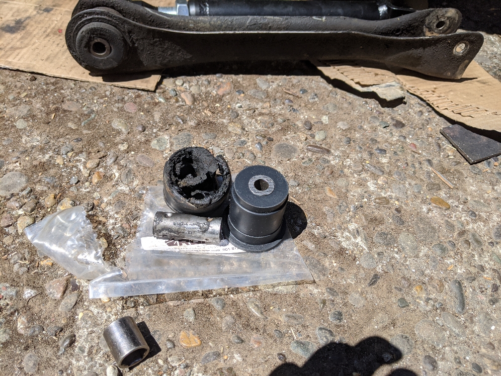

I had planned on installing adjustable upper and lower control arms that I ordered from Protune Suspension but it look like they sent me the wrong uppers :( so that'll have to wait.

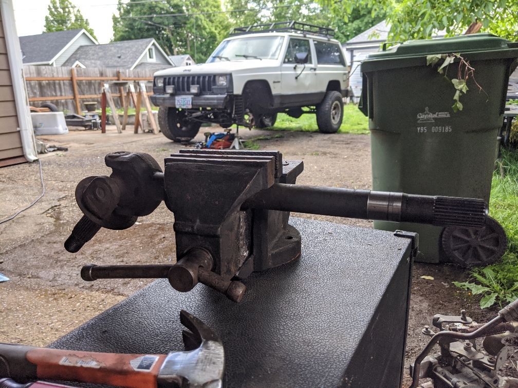

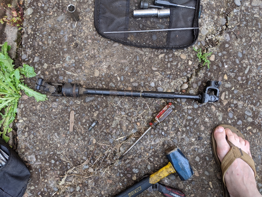

Finally tracked down a problem I was having with my steering being a hard in a few spots. Steering shaft ujoint on the fire wall side only moved in one axis. Those are a pain to replace.

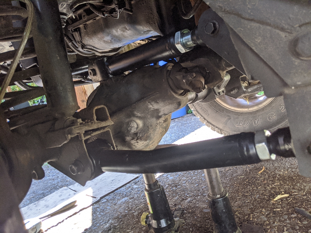

Sold bumpers, installed stock rear as placeholder and waiting on Dirtbound Front Winch bumper. Also install the Stinkyfab Tranny Mount. Makes a big difference in the way the Jeep shifts/drives. Lowering the XJ a few inches soon and then finally take it out for a shake-down run.

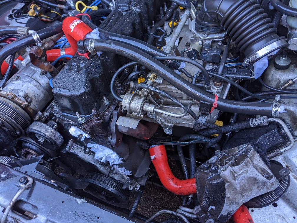

Water pump gasket blew out. Got the old stuff removed and cleaned up. Will be installing a new pump, thermostat and tstat housing later today. This happened a day after taking the jeep on a ~500 mile camping trip/trail ride. I'm glad it waited till I got home to blow!

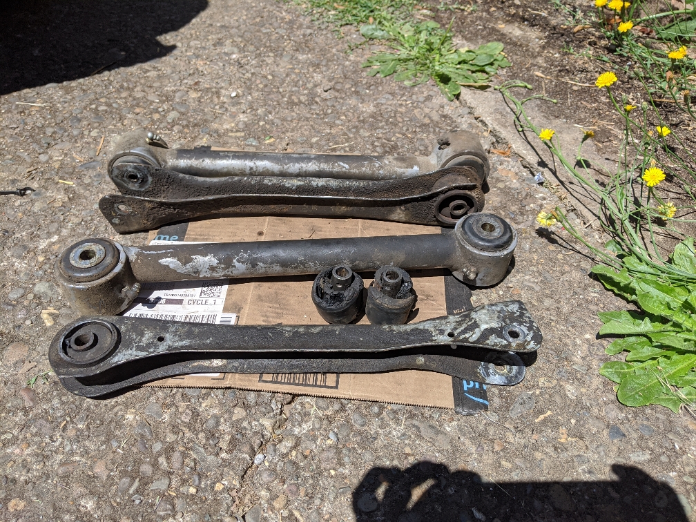

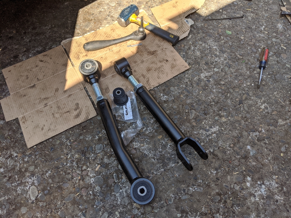

Good Stuff man! I bet those new arms made a big difference
They sure did! It's a much smoother ride now and not quite as much poping up front :). I still need to install the front and rear frame stiffeners then it should be pretty solid all around.

I did some Rocker replacements on my old ride. Took some 2x8 and shoved it in there and welded it up. It made a huge difference for stiffing everything up. Also gave a place to tie in a cage.

Thanks! I have a some 2x6's that I'm thinking about doing that with someday

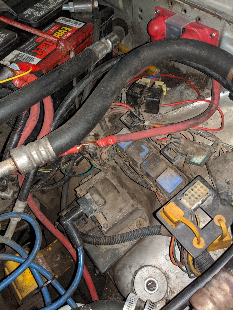

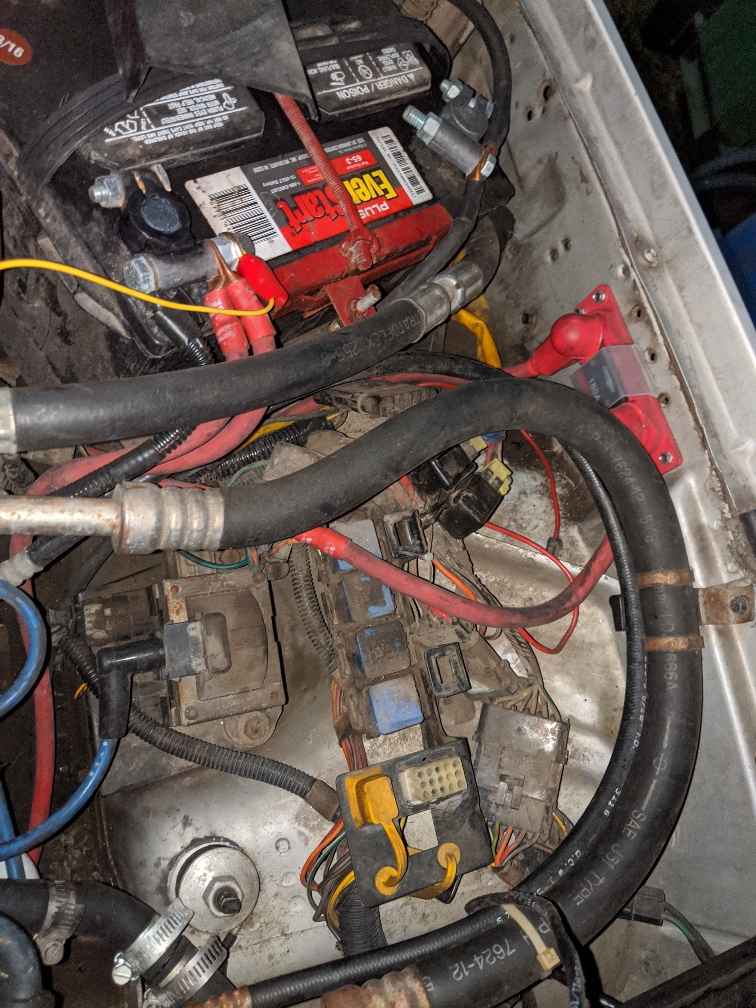

After photos? I haven’t seem many Renix Jeeps with the extra in line fuse mounted up so I’m wondering where you put it at.
Two gauge wires?
Two gauge wires?
I got the renix kit, XJREN2GA. And yea, I went with 2 gauge.
I mounted the fuse on the passenger side just behind my battery. I'll try to get some better pics of all the cables be daylight tomorrow if you want.
I like them. I didn't notice a huge difference but I think that I will once I run through Cruiser54's ground refreshing/c101 eliminate.
