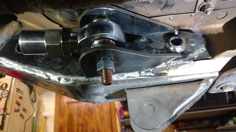

Got pretty much all the new frame plating done. Starting on upper link mount now. The hole on the right is a small tube that connects the frame plate to outer frame plate to help "box" it all in. Links should all be pretty close to same length like this. I made another piece to tie the two link tabs together. Anyone has any suggestions let me know!
Should be strong enough, but it hangs kinda low it's lower than my front lower mounts which are the Claytons early non pocket style mounts and if you recall I hung up easy on that with even slightly bad tire placement with 44s . If I was building fresh I'd probably aim for the lower mount being flush with the rail and cut the tub if needed to get the vertical separation between the mounts if needed . The good thing about this low hanging mount is it will make getting a flatter angle on the arms easier with moderate lift .
I will also say if this is a single upper link set up go big on the mount and big on the bolt size because you now have coilovers and if that link let's go it's going to be expensive.
It's a 5/8 bolt. The lowers are 3/4 bolts. I might just drill it to 3/4 then since I have enough bolts and misalignment spacers. And yess it's a 3 link. I know the mounts are low but these links aren't going to be crazy long so they won't be hanging low way far back. Really the setup will be pretty similar to in4arides telluride build which seemed like it worked pretty well.
Is this for the front? My rusty 4 link has the lower control arm mounts under the frame rail too and hit them regularly.
Yes for the front
My front lower arms were standard off the shelve length Clayton front control arms mounted a bit higher than the bottom of the frame rail they still found rocks with 42s and 44s . But my driving sucks I'm no Shannon Campbell. That said I really never do get stuck on them just on that one bit of nothing spot on chinamans harder trails like carnage I never had an issue , so like I said my driving sucks.
What are you doing out back? Tire size?
With the 35’s I haven’t been hung up on those lower arm mounts, but I do still hit them. It’s always a compromise, especially with XJ’s. I do think you’ve got the mount integrated very well. It looks good.
Just gonna rock the leafs out back for now. Will be on at least 37s maybe 40s but not bigger. I figured the lowers would hit now and then. Everything else is tucked up high and I really didn't want my mounts on the cross member. Seems like either the mounts hang down a little or everything ends up thru the floor. Thanks for the replies.
