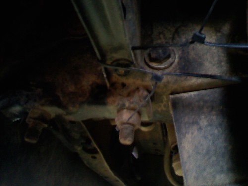

Theoretical situation: Let's say I know a guy that bought a green jeep. This green jeep he bought has a tow hook on the front. Upon further inspection this hook is both bolted and welded. How does that fit in?
Something that may or may not look like this:
Cannot tell in that crappy picture, but it looks like a hook that is welded and bolted to the unibody. Not to a bracket or bumper, so it would fail.
I'd be wary of any cast tow hook that was heated up and cooled rapidly during welding, regardless of where it was welded to.
I'm not a metallurgist, but it just doesn't sound like a good idea.
Exactly any hook welded to anything will fail the inspection.
Most aftermarket hooks are cast, so it isn't a good idea to weld them on. However, there are some OE style hools that are not cast, but rather bent bar stock. This type of hook is fine to weld to, but it must be welded to something of structural strength. It doesn't matter if you have a tow hook off an M60 tank, if its welded/bolted to sheet metal, its not going to do any good. Im sure Glenn is more than capable of seeing what is safe and what isn't and making the call on that, but the general idea here is that welded tow hooks is a bad idea.
While this is true you can never know if a welder that you have never met is any good or not......Just because a weld looks pretty doesn't always mean it is.
There are quality standards for bolts and it is easy to determine if the correct bolt is used.
