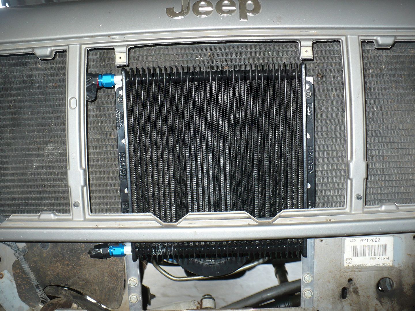

If the T-Cooler is not touching the radiator, it looks good to me! I know some people - prob RCP Phx, believe you should never support a secondary cooler with the radiator fins, and metal tabs should come down from the core support to mount a Trannny Cooler. I have seen them mounted both ways, with no problems. Of course you just have to make sure everything clears when you put the front end back on, but I don't see a problem.

Meh, I've known many many people who've done the same l, without issue. They're not physically touching, and this is a rig I'll be overly beating on by any means. The main reason I got thr trans cooler is for mountain passes, not rock crawling. As long as the mount is secured well, and has not wiggle room, it will be fine.
The trans cooler is one of the areas I made sure to not go head on overthinking it.
Is solid mount better? Sure. Is the mounting style I went with fine? Yes.
