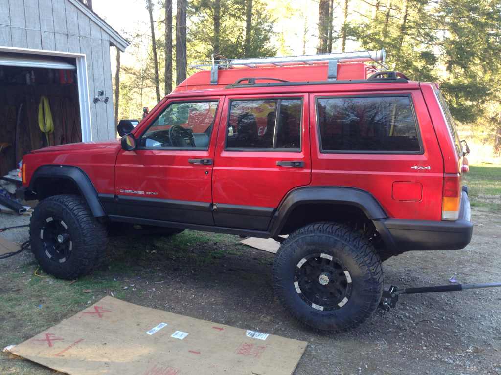

My xj sat for 3 years before I bought it, after fixing so many things Shes finally running. Only issue is torque converter making like a slight grinding noise like it has corrosion on it or something.
Any advice? Jeep is. 2000 sport with 90k on it. Tranny was rebuilt at 80k. Haven't put more than a mile on it since I revived it after sitting on gravel for three years. Wondering if it will go away as the jeep is driven or if its something I need to address.

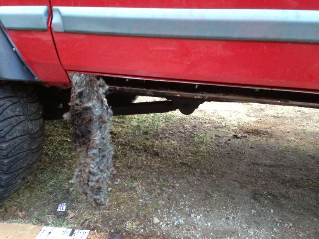

This is what I found in the rockers.
I guess is kind of sounds like metal on metal, not really though sounds more like a dry bearing. Ill pull the plate tommorrow the mouse nest is def a possibility. The only other symptom is with foot on brake and shifting through the tranny it kinda feels like it wants to jump a little. Not really too bad but I do t know what is normal. My last jeep had an ax-15.
I'm a pretty decent mechanic, I've never did any tranny work though. The animal thing definitely makes some sense though.
DA FAQ? how about rot, much of that in there?
