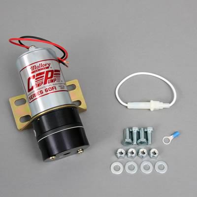

Among a few things I ordered from them about an hour ago, I already have tracking for this:

Bill why did you go with that pump as opposed to this one?
http://www.summitracing.com/parts/MSD-2225/
I think for OBD I i need about 40 psi and this MSD pump is cheaper than the one you ordered. Any certain reason? Or do the later model-year Jeeps need higher fuel pressure?? Did you order fittings etc as well? I need to figure out what I'll need for all those shenanigans and then put together and order there for myself...

I looked into that pump, I avoided it mainly because I did research on that MSD unit and it didn't get the greatest reviews as far as longevity. SummitRacing price matched the Mallory 4060FI pump I got, so it really wasn't all that much more than the one you listed anyway. Plus it'll compliment my Mallory 4305M regulator nicely.
OBDII XJs require 49psi, older ones are 32-39psi.
Fittings? All I'll say on the subject is AN fittings are blasted expensive.
Once the stuff arrives, I'll have everything to feed the engine now however.
Yeah they certainly seem like they're gonna add up quick. I'm just kind of lost as to what exactly I'll need. I'm sure Scott can help me out if nothing else, though. I'd love to be able to get everything and have it in by the 9th but I doubt that'll happen. And, I thought the pressure is regulated at the fuel rail? Do I need to get a different regulator when setting all of this up? Or is that only needed when using a pump with (for example) 70psi, to bring it down to the 32-39 range I need? This stuff's interesting, but I think I might have opened a can of worms... Nothin new :gee:
Bills got a obd2 xj which the reg is part of the intank pump, so he'll need to set his reg for 49 psi. The obd1 which runs @ 32-39 will reg the pump off the rail no matter the pump. You won't need that many fittings so it shouldn't be too expensive.
badass :thumbup: How about the pump? As far as Bill's research showing the MSD's tendancy to fail sooner than the Mallory he got?
Right, without a regulator you can cut down on the fittings, but you'll still need to plumb a line all the way back to the cell. Depending on the hose you chose that in itself is pricey.
Look for yourself, do some searching (not just on here, try the PBB and Google). Summit also has the same pump, just relabeled with their own name for a few bucks cheaper.
Something to also consider, I didn't want a pump that was already on its maximum rated PSI (MSD states 40psi, you need ~39psi) just to feed the engine. Might not be a big deal, maybe I am over thinking it but it just seemed not right to me.
Yeah, I've done some searching around, just difficult to make heads or tails of some of it. I'm forging ahead though!!
