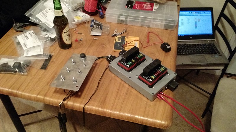

Stupid question, I think.
I'm controlling all my relays with the coils all bussed to +12, and grounding at the switches. I'd like to have a status light at the switch as well and obviously a regular illuminated switch won't work in that case.
Any reason I can't just have an LED wired with constant +12 to its anode, and cathode tied to the same side of the switch as the relay coil, so it grounds both the coil and the LED when flipped?
That's the right way to switch relays, first of all.
Second, yes, will work great.

I (now) know it is, after designing the whole wiring scheme for the truck from scratch - aside from being right in principle, it greatly simplifies a lot of things and gets rid of many redundant wires and failure points. The main switch panel has no +12V to it at all.
The auxiliary panel (by the steering wheel, which has the f/r E-lockers, winch arm/in/out, etc) is where I'm putting indicator lights.

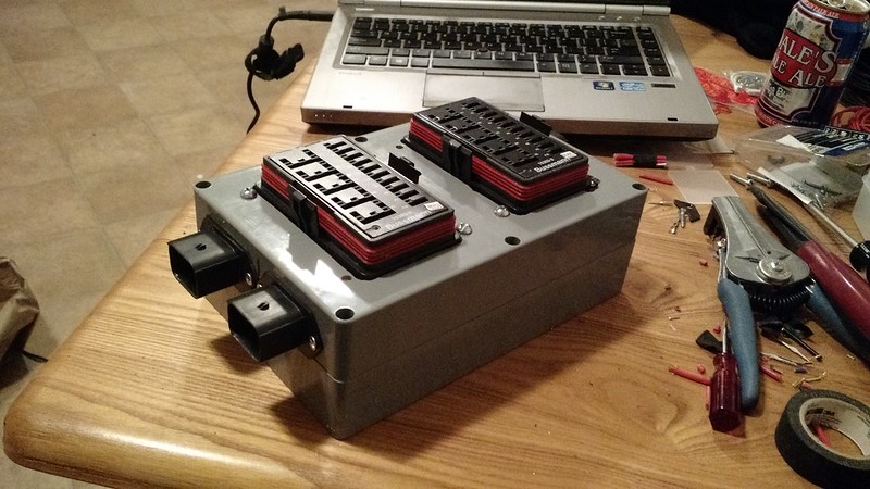

Damn Chris that wiring looks great. Where did you get that plastic box setup? Are they deutz plugs coming in/out of it? Something like that would be nice to keep the wiring in the truck clean.
Re: THe NAC Lots-O-Post Thread aka North America Home Owners Association Thread
^^ yep that's all it is.
The panel-mount connectors are Molex MX150L, and the whole thing should still be fairly waterproof as all the connectors are gasketed externally, the plugs are sealed when connected, and when the fuse/relay panel covers are in place they're waterproof as well.
Not that it really matters, because there are no components inside the box anyway, and the fuse/relay panels are sealed from the back side as well (they use Metripak hardware and wire seals).
