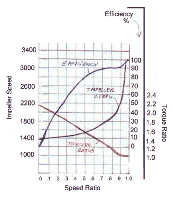

exerpt: Fluid coupling or torque converter: A hydraulic device connecting the engine and the transmission. It takes the place of a mechanical clutch, allowing the engine to remain running at rest without stalling. A torque converter is a fluid coupling that also provides a variable amount of torque multiplication at low engine speeds, increasing "breakaway" acceleration.
depending on the stall rate etc an auto can multiply the torque up to 5 times
That is why an auto crawls better, less HP is needed to do the same job.
Rock,
I'm not trying to flame you, but you really don't know what you are talking about.:mad: A torque converter acts as a gear reduction device and you are confusing that with multiplication of torque to the drive wheels.
There is a good write up an MIT student did on effeiciency of torque converters: http://web.mit.edu/2.972/www/reports/torque_converter/torque_converter.htm
To boil it down, torque converters are less efficient at converting the torque an engine produces to the rear drive wheels (or front wheels, or whatever).
You are assuming, incorrectly, that because it is generally "easier" to wheel with an automatic, that the must inherently be "better" or more efficient. In fact, it has to due with the different gear ratios of an automatic transmission due to the gear reduction of the torque converter and low speeds. A properly geared manual transmission is just as easy to wheel with. Most people do not have manual transmissions geared for wheeling.
Thank you for getting to this before I did.
Regardless of gear ratio, you're stuck with however much horsepower your motor is putting out. A torque converter adds torque at the expense of output speed (and efficiency in some cases). It can't add or create any additional power. The torque multiplication is inversely related to the amount of slip in the converter, and with slip comes fluid losses, heat buildup, and a loss of efficiency. Depicted well in this graph:
In that sense, my doubler box does exactly the same thing, but with a fixed ratio of torque increase and speed loss. The torque converter in an auto essentially acts as a continously-variable reduction box.
