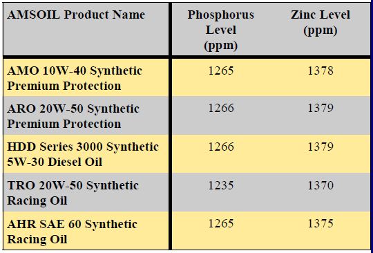

I don't understand your logic of not using Amsoil because of a friction modifier.
The ECTED specifically stated that it should use conventional oil. It also requires friction modifier. It has plate clutches that chatters in tight turns if no modifier is used.
