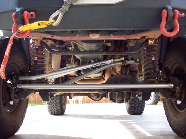

What does everyone think of the ORO U-turn steering?
http://www.jeepforum.com/forum/f11/those-who-have-oro-u-turn-steering-post-pics-401708/
One of the local to me off-road shop owners said he designed the original kit. Then later sold the idea/setup to his friend. Supposed to be the best plug n pray/bolt-in setup available for the XJ.
I thought about going that route, but I found a deal on WJ swap parts.
Yep, I did take that into account. However going OTK appears to open up a new can of worms with other components so it was a tradeoff I was willing to make, given this is my daily driver too.
