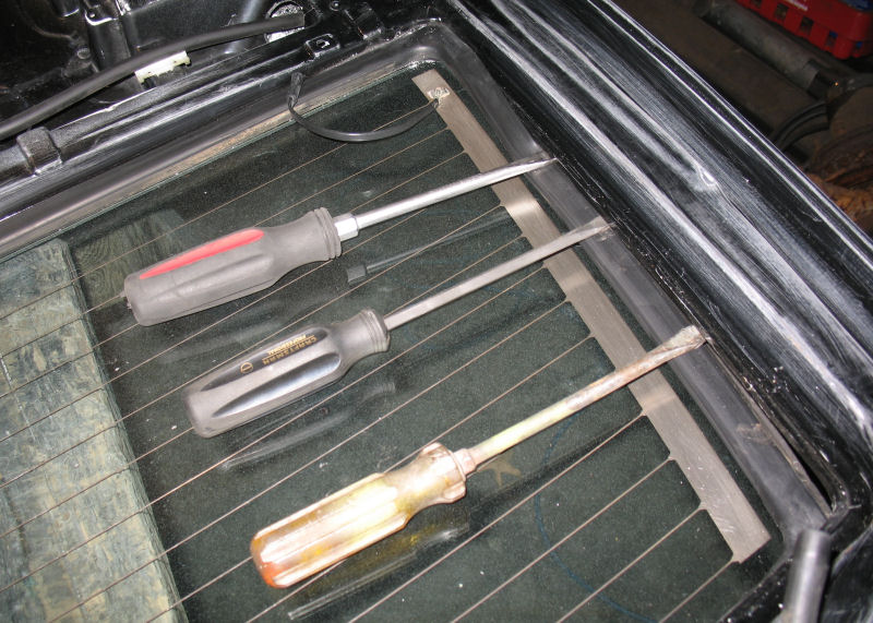

Finally found some time to start on this and taking a short break.
The rear window trim rubber is out, intact. I've got all the dirt and any loose sealer pulled out, and wiped down with alcohol. It looks like the seal separated slightly right at the upper corners. I'm going to caulk it up and then try reinstalling the original rubber trim, since I can't find a new one anywhere. Looks like a challenge to reinstall without pulling the rear slider window. I might wipe it down the inside face with touch of silicon lube to help it slide back in. I might have to trim the inside lip that hooks around the window on the corners a bit too.
All back together now. I dug out the top corners where I think it was leaking, and caulked the top and sides with a urethane-based caulk (no point doing the bottom edge). I trimmed the inside lip of the rubber where it's supposed to hook around the slider frame on the corners to make things easier. It was still a bitch to get the trim pushed back into place with putty knives, screwdriver, and a mallet. The trim is not perfectly flat, but it was a little curled and uneven in places to begin with.
In hindsight, it would have been far easier to have just lifted up the edge of the trim and squirt a thick bead of caulk under it. Instead what could have been a 30-minute job turned into 2-1/2 hours with lots of cussing at the rubber trim piece.
