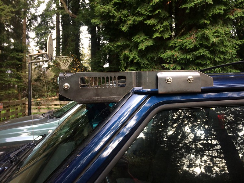

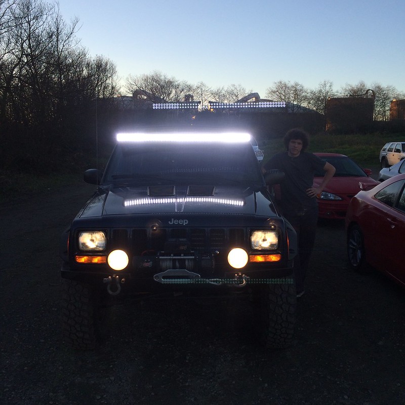

50 inch Chinese light bar with Hooligan Offroad mounts-
50 Inches of Daylight by Sean Mitchell 707, on Flickr
Lots of light! Kinda stupid, but it was 300 bucks haha.

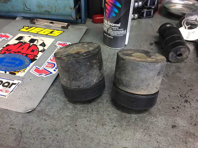

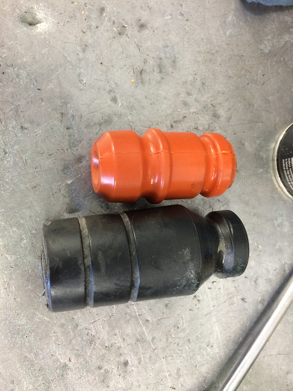

I had those Daystar extended bumpstops up front, hitting RE lower extensions. Holy crap were they too hard. No absorption whatsoever.

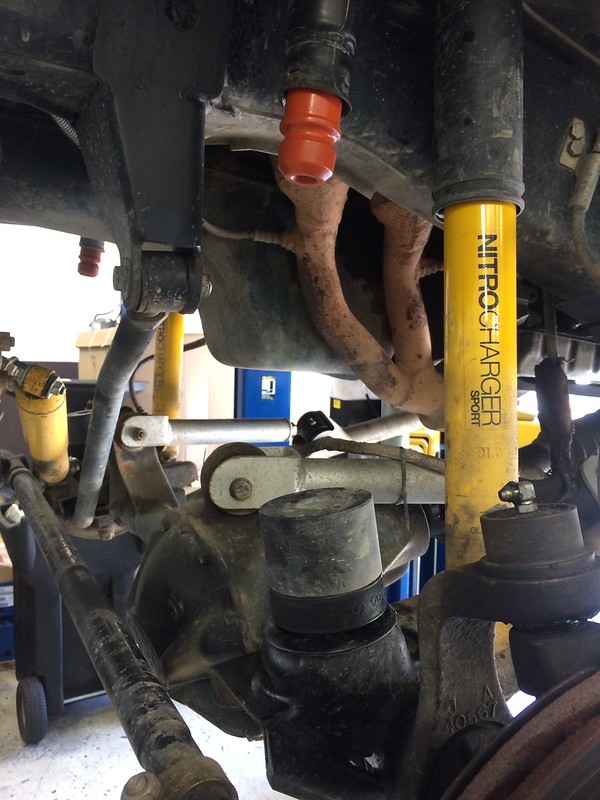

Saturday- swapped in crown stock replacements. Eventually I'm going to get the Prothane coil inserts...
Jan/Feb 15 by Sean Mitchell 707, on Flickr
Drilled some hockey pucks to make up the length.

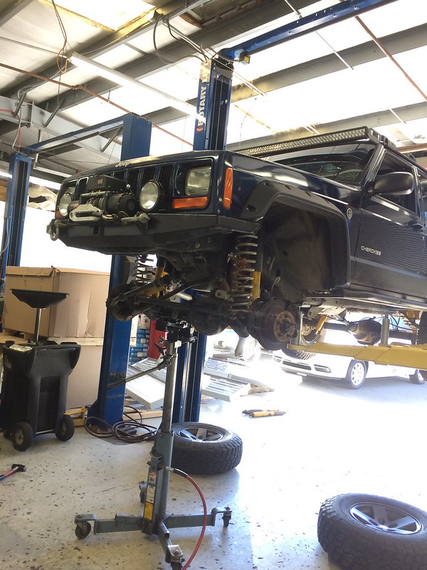

Oh, and having a shop to do work is killer! Had the coils out within 5 minutes of having the wheels off.

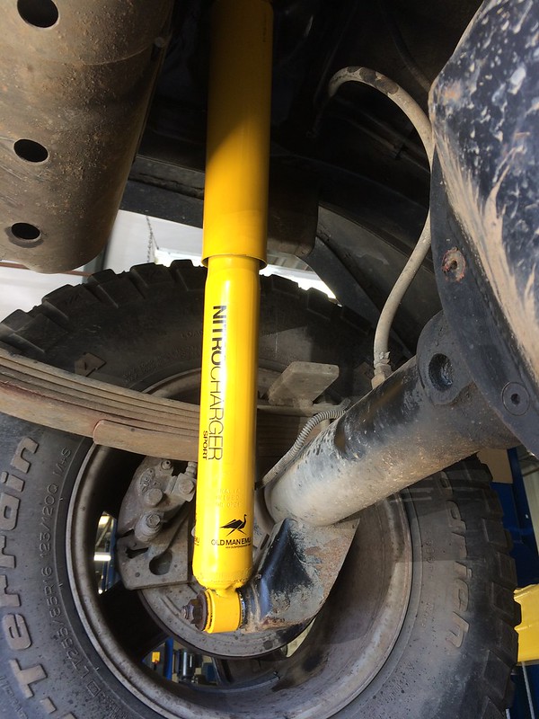

New OME Shocks out back, to replace my worn units from 2009. 45,000 miles of use... They were shot.
