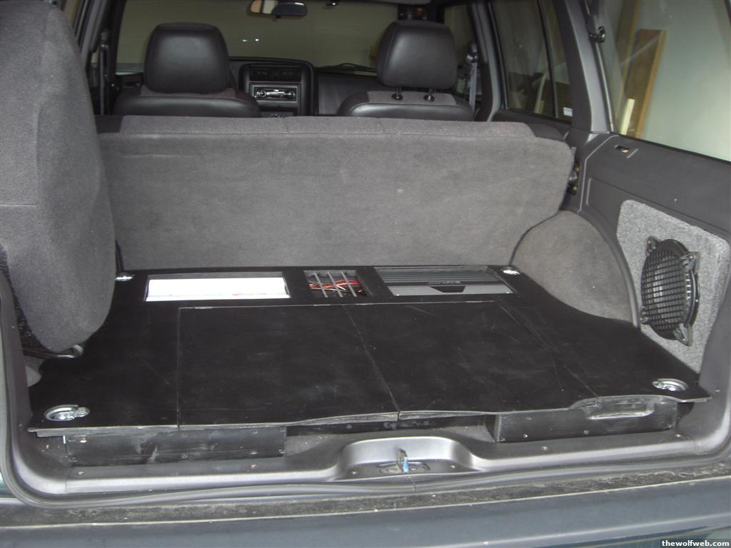

A few more including while under construction. These are all I have. Any specific questions I may be able to answer.
nice box. what type of plywood did you use?
Thanks,
Birch, 5/8" and then added marine spar finish. Glued and countersunk, screwed with the exception of the top which is screwed and L-bracketed down.
Bolted through the stock hold down mounts with fender washers. 300lb slides. I added a bottle opener and a magnet. Have inverter built in as well as 12v receptacles for the fridge and other accessories.
