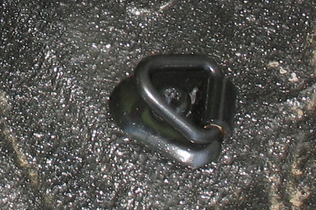

Quick question. Was the floor/subframe thick enough were the tie down's are to just use a bolt? Or did you have to use a nut on the under side?
I want to replace my tie down's, but I'm not sure if the metal is thick enough to support a bolt without a nut.
The stock tie-downs screw into the floor. For anything heavier, a nut for the bolt is going to be needed.

Mine are riveted down. Somebody told me that the under side are inside the subframe. Unless Jeep ran fuel/brake/electrical down the inside of the subframe rail it should be pretty safe. I'm just curious how thick the metal is and if it will allow for a bolt without a nut.

I had to hunt around for safe spot to put a nut. I did not try to go through the framerail since I thought it would be easier to put a nut on the outside of it

I replaced the rivits with bolts. There was access under Jeep for washers and nuts.

My OEM tie-downs were pretty much rusted out and only held on with a rivet. I drilled them out and replaced them with a 5/16 grade 8 bolt and lock nut. I then made the tie-down straps and put them in the stock locations (I need to add some more). They work great and hold down the cargo securely with some ratchet straps.
