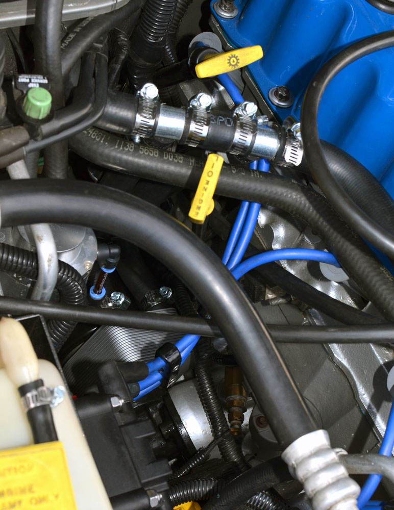

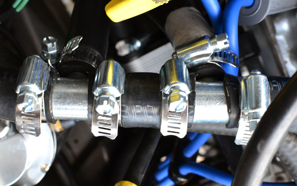

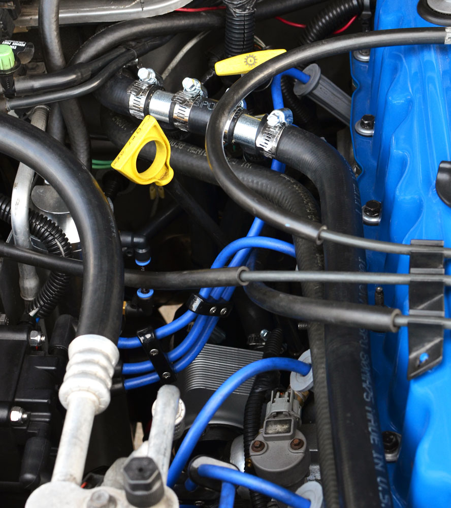

The heat exchanger has been functional for about a week now. I used two Dayco 80402 hoses. They are 5/8" ID, with a 90* bend and a straight 18" piece after that. Of course they had to be trimmed. The tee fittings are angled 30* rearward. The tees were from: http://coldhose.com/specialty-fittings/heater-hose-fittings.html. One had a reducer bushing installed as mentioned above.
Temps are roughly 20+* warmer at given time. I'm going to do some more logging and post some more numbers later. Of course temp will also vary based on ambient. To get to this point total cost is $116(heat exchanger, tees, bushing, hose, and clamps). So far I am happy with the outcome.

I'm glad you went back and read the thread. Yes, you can just install the oil heat exchanger behind the stock filter mount and install the filter behind that. That is how it is currently. I'm going with the remote mount oil filter in the future for a few reasons. 1) Getting to the oil filter is now a pain. But my engine bay probably isn't like yours. I also have a Viper coil and oil catch can located in the vicinity. 2) I want to use a larger filter and with the heat exchanger I won't have room. I'm going with one significantly larger than stock. 3) Once the remove filter adapter is attached to the back of the heat exchanger there will be less of a chance for leaks and the filter will not be spunb on and off the heat exchanger.
The heat exchanger will stay in that location. I had though about moving it to the remote filter mount but since I went with a different size remote mount that isn't an option.
To get this far I have:
1 x heat exchanger: 4792912AE
2 x 5/8" x 3/4" tee fittings: #H1953 http://coldhose.com/specialty-fittings/heater-hose-fittings.html
1 x improvised reducer bushing from lowes.
2 x Dayco 80402 hoses
4 x hose clamps for 5/8" hose
4 x hose clamps for 3/4" hose
Thank you Talyn. I can't see where your filter is in the photo. Your filter is horizontal, correct? Mine is vertical, so I would have more room than you? I have also installed a coolant filter, which is Teed into the heater hose coming off the thermostat.
Would you foresee any issues with taping off the same hose for the line to the heat exchanger? Finally, is not the Mopar heat exchanger a better way to go vs.the Hesco? It appears in photos to be well engineered, and I'm not sure of the quality of the Hesco unit.
Thank you. Your attention to detail and workmanship is an inspiration!
Yes, my filter is horizontal. I don't know if you need more room or not for it since yours is vertical. No problem teeing in to the filter line. Hesco's is quite expensive. Also, I do not know who makes it. I'm not taking a chance with something like this. I know that the Mopar one is made by Dana/Long.
