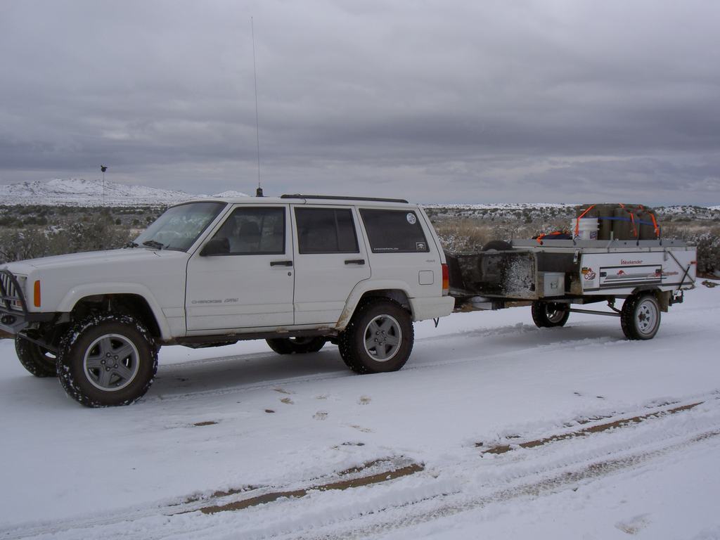

Here's some pics of what I have come up with....
Travis'ssss came out NICE... I wish I could say that there has been progress... BUT !!! too many irons in the fire... along with some laziness.
See YA !
Curt

Looking good Sean. How about some bigger pics so we can see a little detail...

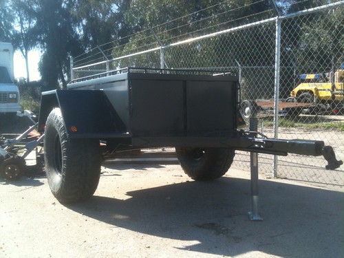

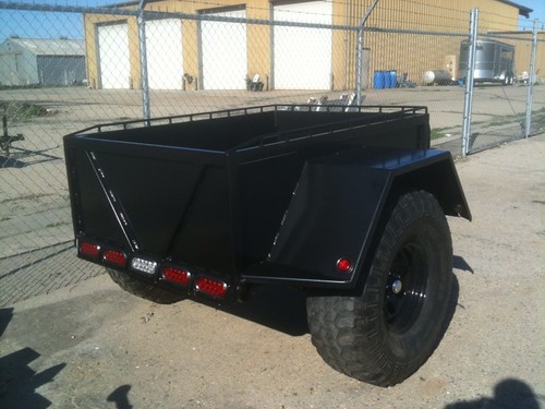

Maybe these are better....
Nice work! The build and the paint both look very clean. What kind of coupler is that and what route did you go with for suspension?
Lock n roll coupler, standard leaf spring suspension, powdercoat for paint. It was a fun project now I just need to finish the wiring and hook up the rock lights underneath. Tires are 36" swampers to match what's on my jeep.
