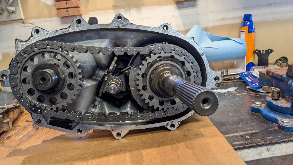

Hello,
My transfer case was making some pretty gnarly sounds. Almost like a rapid hammering or clanking. Mostly noted when turning in 4wheel PT or accelerating quickly in 4Wheel FT. I wish I had left the TC in longer to get more diagnostic info. I was hoping when I cracked it open it would be obvious what to do.
I'm hoping some folks can tell me the standard things to look at or replace.

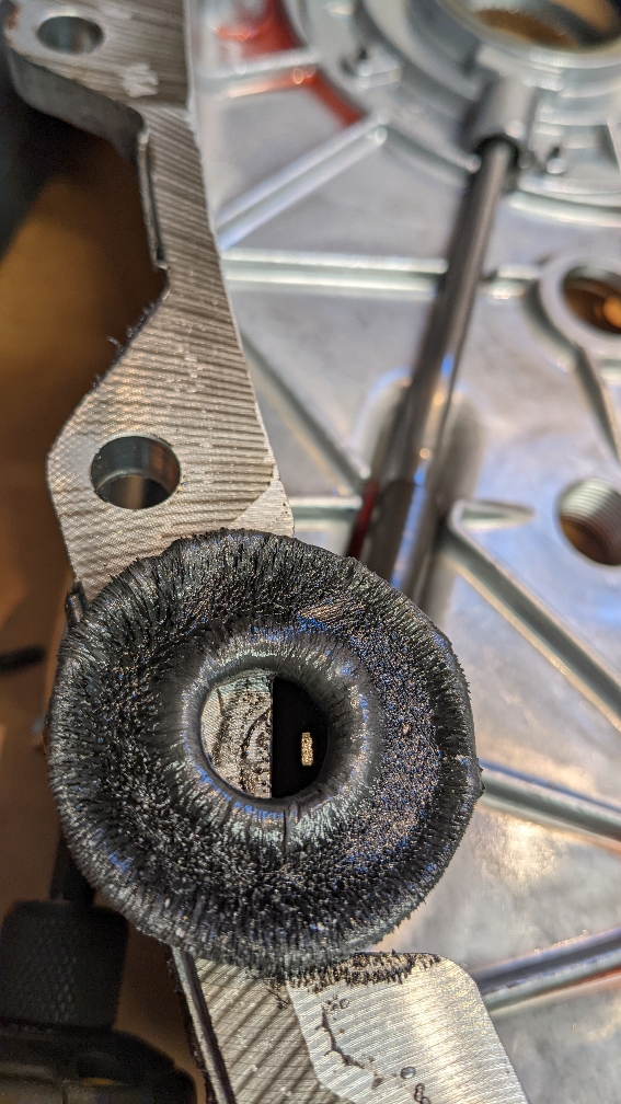

The oil didn't have any plastic that I could see. And metal shavings looked minimum.
I will include a photo of the magnet. And a few other photos.

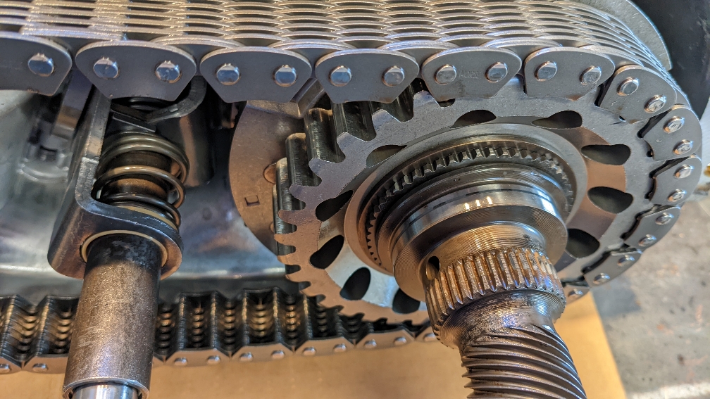

It looks pretty clean. I can't tell if the chain is stretched. I assume I might as well replace that since it's out.
But any other thought or info on what is a must to replace when it's out, or anything specific I should look at would be appreciated!
Thanks
Cullen

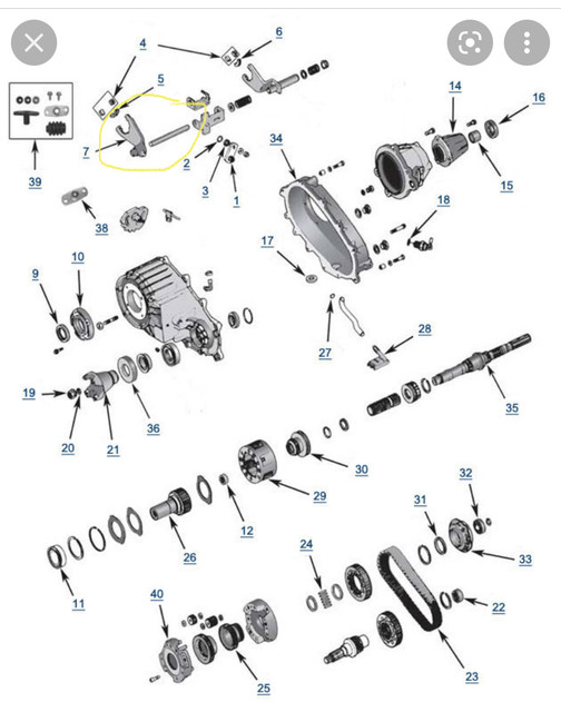

Popping or clunking under hard acceleration is very likely a stretched chain. Change out the shift fork tabs also, and check the shift fork itself for abnormal wear.
Since it is out and open, replace the chain with a top quality brand name part. No auto parts store brands, no OmixAda or Crown Automotive either.
I prefer BorgWarner Morse.
I sure hope I can quiet it down, It was undrivably loud!

I'd change all the bearing that come with the Master bearing kit. For sure a quality chain from BorgWarner Morse is best.
I agree with xcm. Doing a complete tear down and inspecting all the other parts for wear is you best plan of action. Quit a bit of metal shaving picked up on that magnet for sure! Changing all worn parts results in the best rebuild.

Like Tim_MN said. Check the folks and pads too. Source the best quality parts you can afford for you rebuild.
