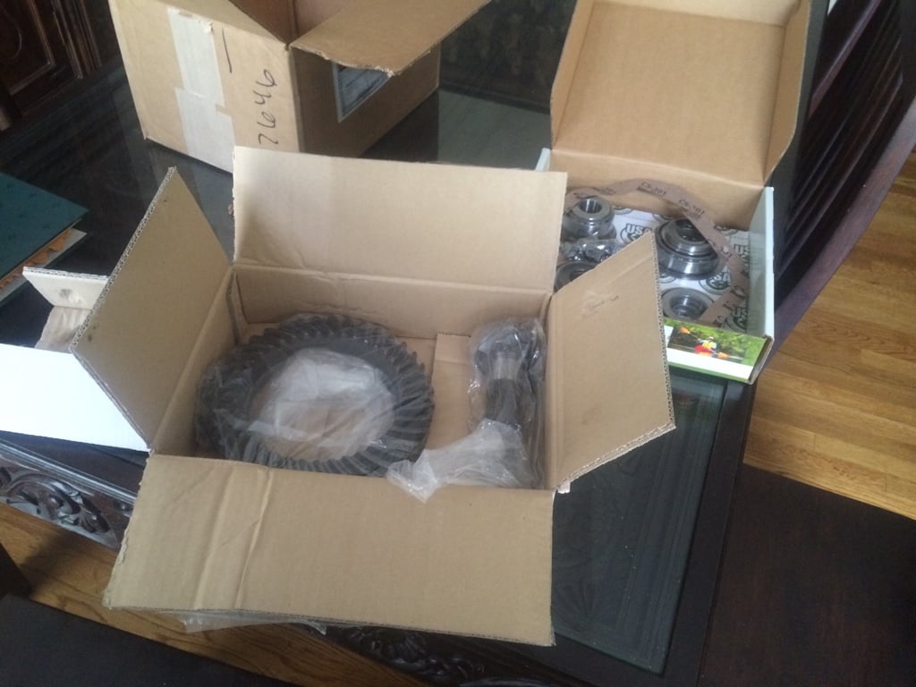

Gears came in over the weekend. Going to ordered ball joints and steering very soon then will be pulling it all back together.. Taking my hubs down to a buddy of mines machine shop some weekend soon to have my hubs redrilled to 8x6.5 and the centers bored for 35 spline.

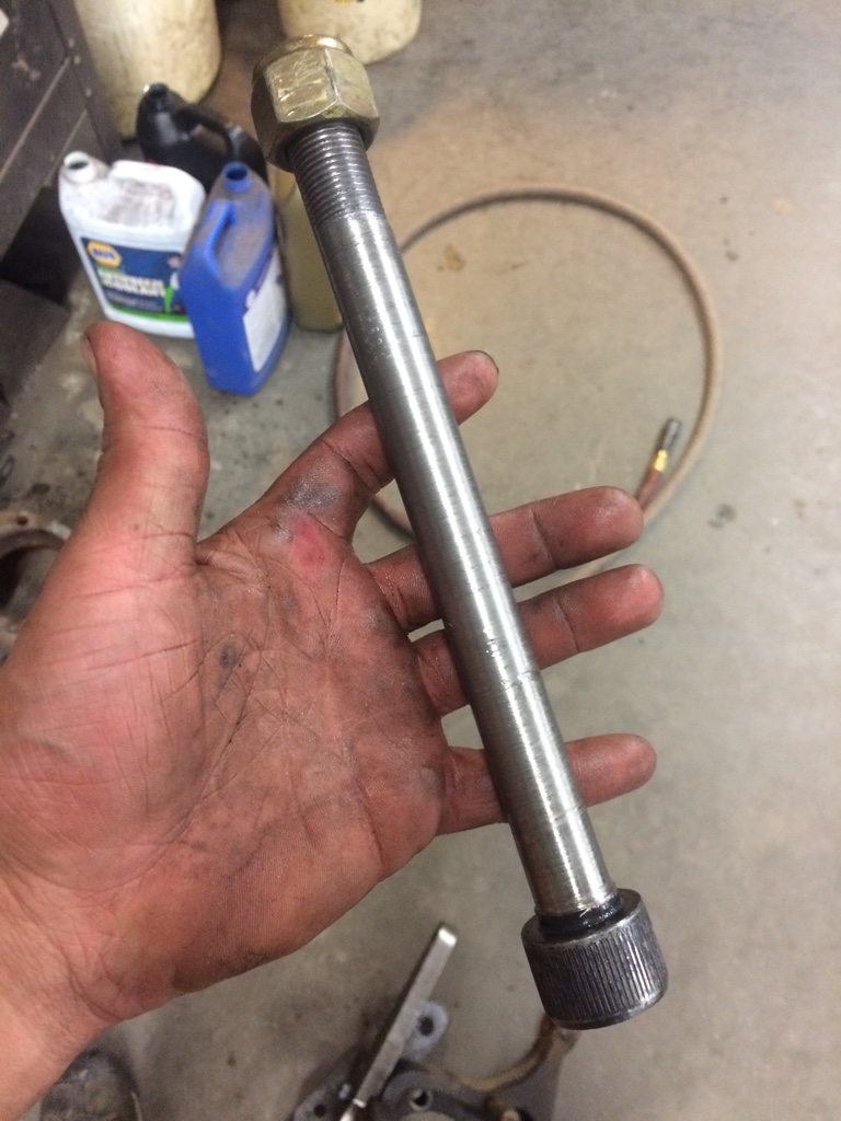

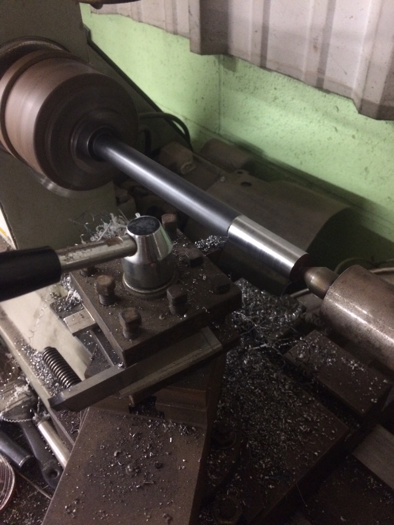

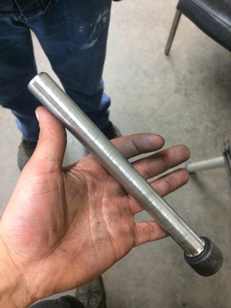

Made some bolts for my knuckles today.. Had some 20mm class 8.8 blanks at the house that were more than long enough. So took them to a shop I use to work at and lathed them down and threaded them 3/4 16. Also ordered steering and ball joints yesterday, should be here either by the end of this week or next.
