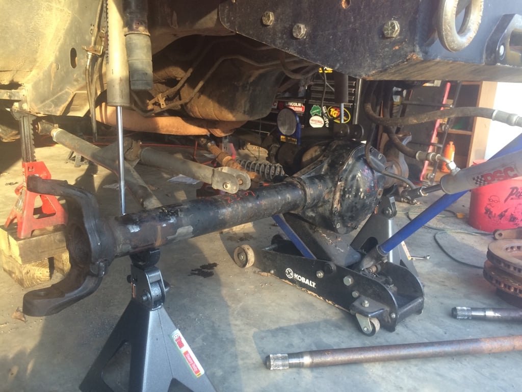

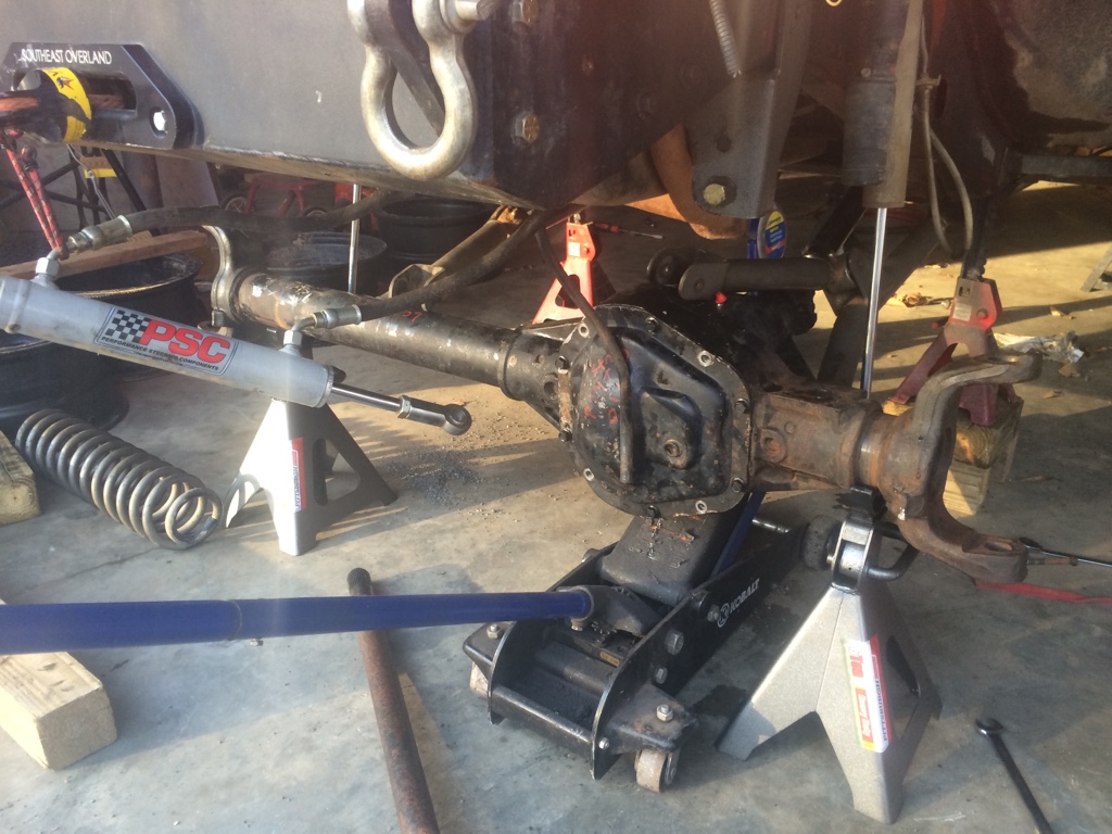

Picked up the new Dana 60 today! Was able to pick it up at a junk yard near by for about $300 complete so I'm happy with that. Will probably start ordering the stuff I need next week and getting a move on with this thing!

I may not be able to tell from the picture but that looks like it is from a ford super duty. If so the housing for a d50 and d60 are identical. the d50 guts are much weaker and they used to not have as many lockers and gears available (that may have changed)
One of the other things with the super duty is the lug pattern is metric so go get the rear axle that was on the same truck so you can run the same wheels front and rear. (which will probably be a sterling 10.5 which will be a much stronger rear axle than a d60)

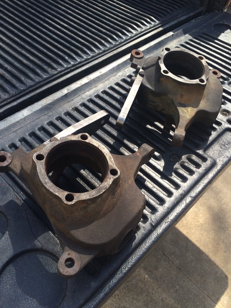

So little update. Picked up probably the smartest thing I've could of bought for this Jeep today. Gonna slow up the process a little bit but found a deal and had to jump on it. Some of the brackets should be here sometime this week so should be getting started on that soon.

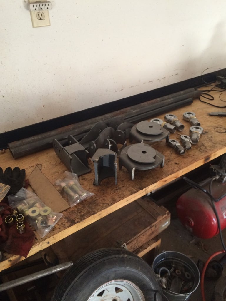

Getting started on this thing tonight! Went and picked up my tires this morning and the rest of my brackets came in earlier today. Gonna try to get as much done tonight as I can see how far I get.
Calling it a night. Got a good bit done over all today. Got two of the 40s mounted up and on the rear axle to help me visualize ride height for the 3 link, Got the the coil buckets and lower mounts on the axle. For the driver side I tried to cut as little as possible out of the pumpkin. I did happen to grind a small hole in it though, no biggie though just welded it back up and forget about it. Got the frame brackets tacked in and PVC lowers mocked up. From the looks of it will work but still need to check tire clearance. The upper PVC mock link is just hanging there at that moment. Might get to tacking it in tomorrow and then the process of cutting out my floor to gain the separation I need between the lowers and upper. Other than that pretty success full night. Will try to get back to it tomorrow.
Got some more done today. Had to knock off a little early to rest for work tonight. Got the upper frame bracket in, made a stiffener plate that I welded to the unibody first then welded the bracket to that. Also plated the hole in my floor as much as I could. I might do a little more work to it a little later on but as for right now it will do. All the links are cut and fitted will probably be this coming weekend before I'll be able to get those burnt in also going to take the axle with me to get the tubes welded to the diff and to come up with some kind of truss to keep my upper on my axle tube. Next thing I'll be trying to get ahold of it some steering components then after that track bar stuff..
