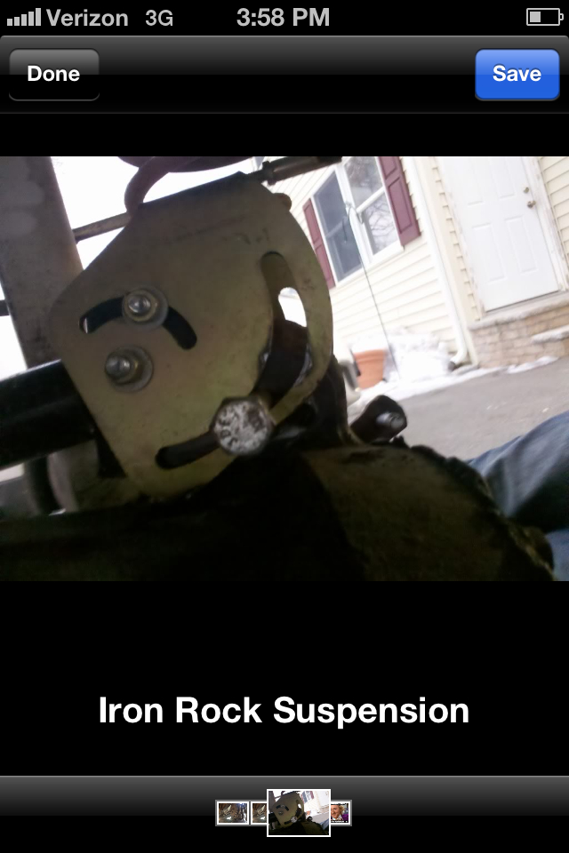

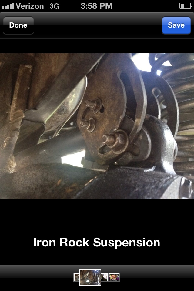

Accept what truth ? That no one can put proof of a ten mm bolt braking on this kit ? I've been looking and can't find but two things on this kit fail. And both were the caster bending not a broken bolt
. 10mm bolt looks to be 100% intact
