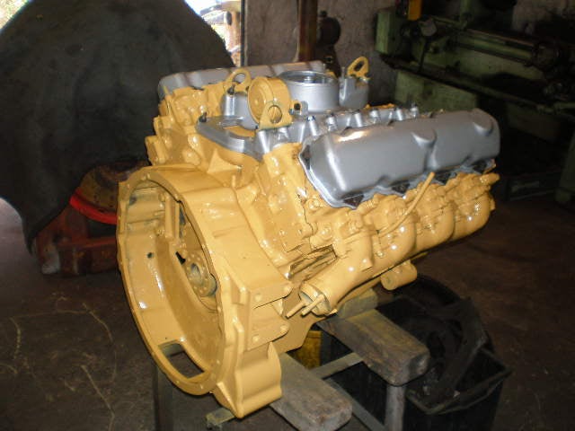

I am trying to figure out what engine/transmission I want to put in the 5 ton when I rebuild it... mostly settled on a 6bt5.9, 6cta8.3, or cat 3x08 with an EF rtx14609b or rtx14609h behind it, but haven't fully decided. It will depend on what I can find cheap.
I found a transmission near me (H ratio one) for $950 supposedly in good used condition, have not found an engine yet. The cat V8 is still in the running because it is in a friend of a friend's small junkyard and there is a chance I can get it for very cheap, otherwise it will probably be a turned-up 12 valve for the 3000rpm redline and $800 max price.

The Cummins I posted a pic of may be for sale cheap. Has a rotary pump on it though.

Page 4175. I dont know a whole lot about it, just took a pic of it one day when I was there.
I do know it has a rotary pump on it and Jed says he paid some ridiculously low price for it. Been sitting for a while, of course I would test run it first.
