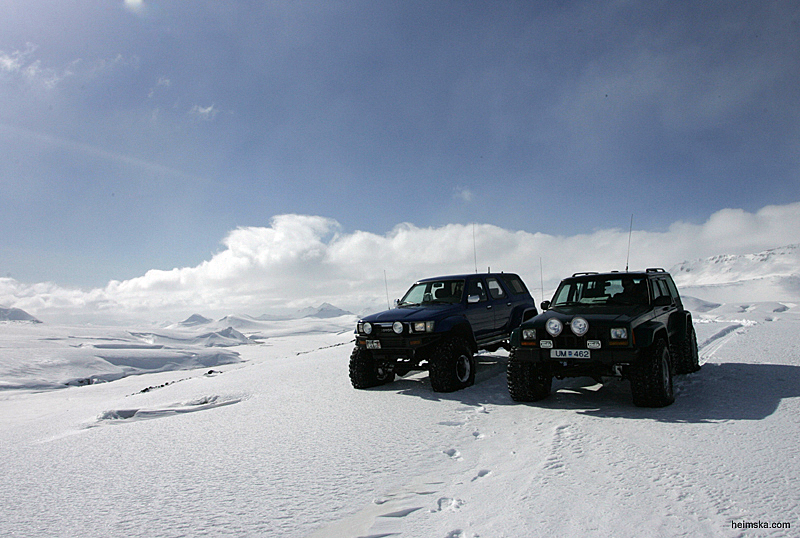

Icelandic XJ on 38" tires
I keep forgetting to ask, is that one of the HiLux support trucks from the Top Gear North Pole Episode?
Awesome work and beautiful photos!
Off topic: thanks for telling the banksters where to go and prosecuting them. Wish we had the balls to do it.

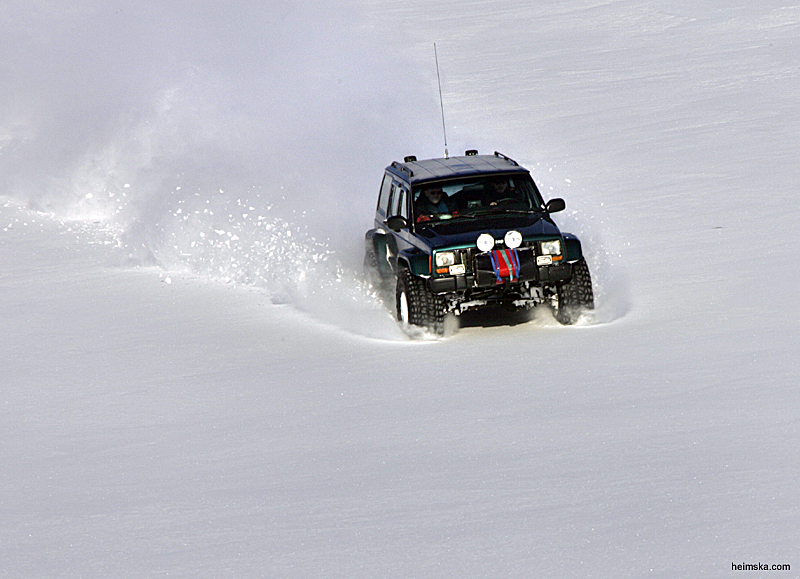

I have a couple questions about your style of offroading. When in the snow do you drive in 4 high or in 4 low? I have a ______________ and want to do more snow driving this winter in the mountains in _________. I have seen people do both style (fast and slow) and want to get your opinion on what to do.
Thanks
I have only 1 time used the 4x4 hi in snow, it was this spring and I drove on 110 km/h down a glacier. I always use the low range, I can get 94 km/h which is alot but have all the tourque when needed and can go slow which is often must.
The key to success in snow driving is NEVER SPIN THE WHEELS! If you spin the wheels the tires dig holes and you stop getting forward and possibly get stuck. The technique is to float on the snow but not dig down to the ground, in some of my pictrues the snow is several meters thick. If the snow is firm it's easy to drive on it but if it'a soft like a powder or wet like a slush its difficult.
Then I let almost all the air out of the tires (at least down to 2 psi but sometimes below 1 psi) and drive slow to not make the tires spin but just crawl over the soft surface. Then I carefully increase the rpm and gain speed untill the engine lacks power or I spin, if a tire starts spinning (even though driving at some speed) I instantly decrease the rpm, sometimes it just takes a tiny slow down to gain the grip again and almost lose no speed but sometimes you have to stop and start all over again.
This Hilux is not one from the Top Gear show. But it's built by one of the workers at the company who built the Top Gear Toyotas and is similar in several ways.
