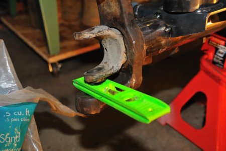

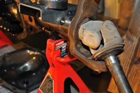

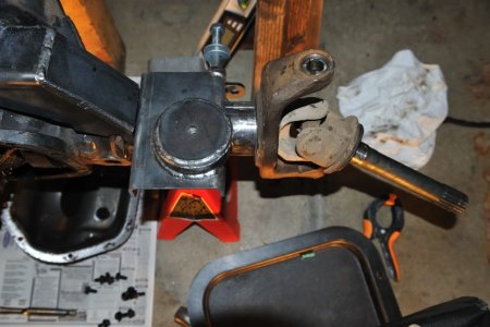

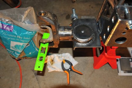

ISSUE: Driver side distance, from center of coil bucket to inside flat edge of Inner C is 3". Passenger side distance, from center of coil bucket to inside flat edge of Inner C is 4.25". Which, in keeping the axle centered under the vehicle, gives me an overall difference of 1.25". This is where I am confused, and believe it should be a difference of .66", should it not? From what I can gather, all my other measurements are within spec.
You can see the difference in distance with these images:
Disregard the green level, i'm only using it to prop the passenger side shaft up.
The only idea I could come up with, to correct the distance, is to narrow the passenger side more than it currently is. I believe I have the room to do so, however I'm not quite sure.

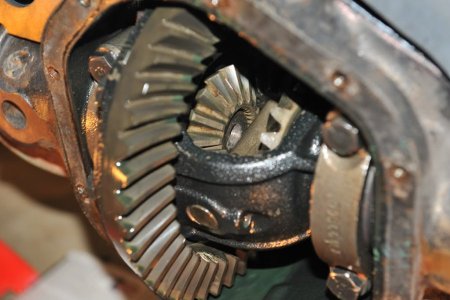

With the shaft sitting as close to the tube as possible, on the passenger side, this is how much spline engagement I have:

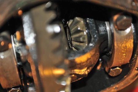

For comparison purposes, this is the amount in which I have on the Driver side:
Yes, the focus on that last shot is awful, but it's clear enough for reference.
