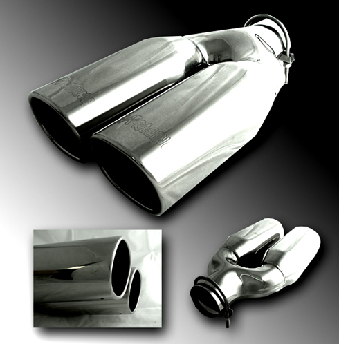

"Is that a dual tip or do you have one pipe running from cylinders 1-3 and one totally separate pipe running from cylinders 4-6? Dual tip is not dual exhaust. Dual headers are still 6-2-1 instead of 6-1"
Neither. It's not a dual tip, and cylinders 1-3 and 4-6 are not "totally seperate". And again... you're an idiot if you think that "dual headers" are 6-2-1.
