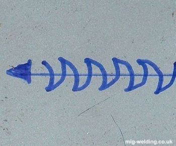

A few tips that may help you out. You have three things going on that affect penetration. Heat setting, wire feed speed and how fast you move the pistol. And number four the trigger, stopping and starting again.
The "C" form has been mentioned. Try thinking of the bead as a series of spot welds. Try using the "C" method, stop at the end, start again from left to right, then again. Like a series of spot welds. Using flux you'll likely have to clean often to get a decent bond.
The object of the exercise, is to get the motion down, muscle learning. I rarely look at my bead, hold my pistol at almost 90 degrees (slightly less). I use gas and run an inch or so of bead, stop, inspect, adjust and do another inch pr so. A little messy using flux though, when you stop you usually have to hit it again with a wire brush ( a wire wheel in a drill works well). An angle grinder with a grinding disc for prep.
People tend to think a constant bead is the way to weld, but in actuality twice as much weld equal to a fastener (bolt) to hold the same two pieces together is enough. It doesn't have to be a total constant bead, a weld is a fastener, enough is enough. When you stop the bead it gives the heat a chance to dissipate some. No reason not to connect a series of one inch beads instead of one continuous bead, heat control may be a good reason to do this. Though this method may require a little more prep and cleaning.
I also tend to speed up on the ends of the "C" and slow down in the middle, after you have the motion down practicing with a series of spot welds and graduate to a constant bead. The reason being, when you change directions at the end of the "C" you are doubling the heat transfer in that spot. This method can be especially helpful welding inside corners.
Nothing says you can't use a piece of metal rod to steady your pistol hand. Pistol in your right hand, rod in your left hand, held at an angle and used to steady your pistol hand. Once you train your brain to the proper motions, you rarely have to look around the pistol tip at the bead, you can concentrate on where your going and occasionally check out where you've already welded.
