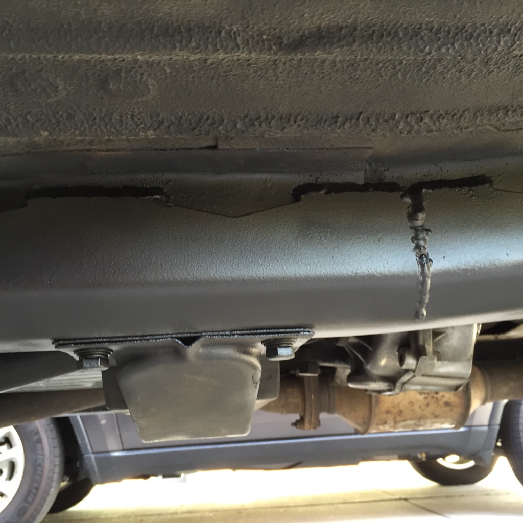

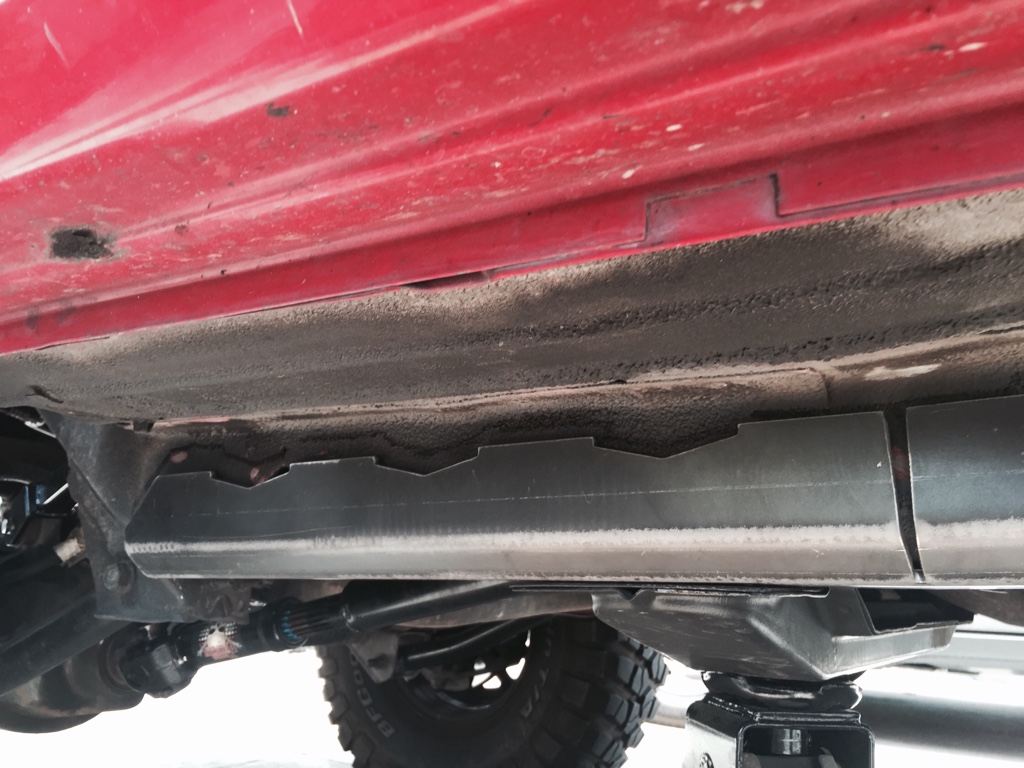

Hooligan Off Road has created a high quality stiffener for your XJ!! CNC cut and press broken in house out of 3/16" steel. With the new wrap around design these stiffeners are the strongest on the market. They require welding by a qualified welder to install. In most cases you will need longer bolts and studs for the crossmember. Shipped in raw steel form ready for welding. They cover from behind the LCA mount all the way back to the forward leaf spring perch. Rosette holes are not needed and no reason for existing frame hole cut outs.

I don't agree with either of these statements. That additional inner wrap around does nothing but create a stress riser.
Weld surface area is extremely important with an application such as this. Not the total surface area of the welds, but the amount of spread between them. This is why I wouldn't use any stiffener without plug weld holes.

I think it's a bad idea. Lots of stress on a single area of the unibody sheetmetal.
Only a matter of time before that line of welds starts to tear.

After reading the specs on Josh's Website the stiffeners he offers are a bot thicker at 3/16th and wrap both sides of the unirail ...they are only $99 right now as well ...I have the HD stiffeners full set ...If Josh was in business in 2010 I may have bought his centers and HD ends because full wrap is a bit better than just one side ... I'd say both are good products and will save you a few hours on making them yourself ...I'm currently adding in the missing sides the HD offroads did not have to better tie into my cage and subframe .
