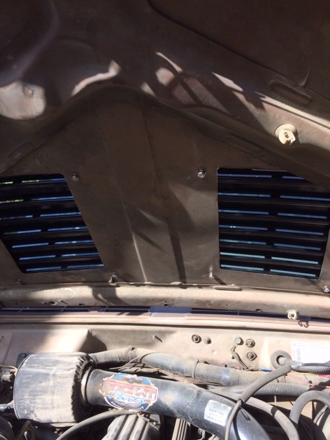

Those look pretty sweet!!! How was installation? Any pics of them from the bottom side of the hood?

I have them. I have long fought with high temperatures, and the Hyline vents are one of the things that have helped.
The kit included a full size metal template that was quite accurate. Their instructions are complete, and they do not take any any of the internal support for the hood.
