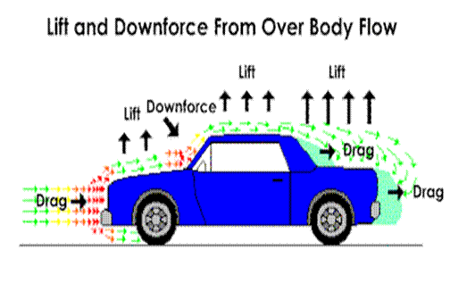

Simpler graphic:
This illustration is very clear,...it is what I expected to see. Thank you.

Agree with your statement, but not it’s applicability here as your example is backwards. Air isn’t leaving the vehicle. Air is hitting it. High relative velocity air is hitting the vehicle with nowhere to go, creating high pressure. Go stick your hand in front of the windshield, then stick it out the open hatch and tell me which air feels faster.
Yes, it will feel faster, due to more velocity, NOT pressure.
Conservation of energy...............if the front of the car & windshield have high pressure, then the back windshield and back of the car have to have low pressure.
The velocity of the air don't matter much, if it is moving, it is happening. The higher the velocity of the air that makes high pressure at the front windshield will also make a lower pressure at the rear windshield.
Just because you have high flow/velocity doesn't mean you will have high pressure. The car example has high velocity air across the back deck, but it has low pressure there.
THAT is what I was saying.

Not sure what you’re trying to say here. There isn’t any relative airspeed behind the rear hatch. The low pressure at the rear isn’t because there’s high pressure up front, it’s due to flow separation because the vehicle is shaped like a brick front and rear.
In any case: why bring this up? For the effects of that diagram (context), higher on the velocity scale at left generally meant higher pressure. Exception to this is the blue are in front of the grille, which appears to be a stagnation problem with that car (hood vents would help :D).
I will admit it was a poor choice in diagram for this discussion. I found it browsing with my phone and didn’t read the text of the scale. In general, the areas on that diagram that are blue are low pressure, and darker green to red are high pressure.
I brought it up because you said the higher on the scale (wind velocity) the higher the pressure, which is not true most of the time.
There is airflow past the roof of the vehicle, and this flow has to widen to cover the rear windshield, which means the velocity will drop and the pressure will drop more. This causes the swirling effect and drag. It is compounded even more as the vehicle body passes, and even more space has to be filled with the same air flow, so the pressure drops even more, and even more drag is produced.
I see what you're saying here, but I think a more accurate way of stating it is airflow over the roof is attached and laminar except at the front behind the windshield since it's in plane and has stabilized. Behind the windshield and the rear hatch is a low pressure zone because the change in angle between the windshield and the roof (or roof and rear hatch) is far too great (generally over 17*) to keep airflow attached, but does not have a clean break, causing turbulent airflow and a low pressure wake, both of which cause drag.
In any case, we've gone so far off into the weeds we're no longer treading lightly. Fact is: the best place for hood venting is towards the front of the hood, not at the back. :D
