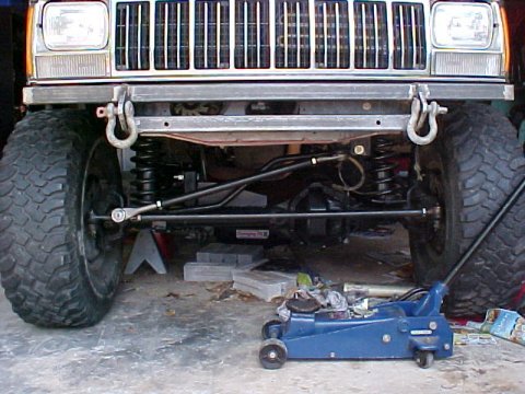

BTW, Fore Wheeler is going to hi-steer, not over the knuckle like in the pictures. He already had that and FUBAR'd it. Right now its One Ton'ifed. I'd say leave it with the angle welded to it. That's sweet.
