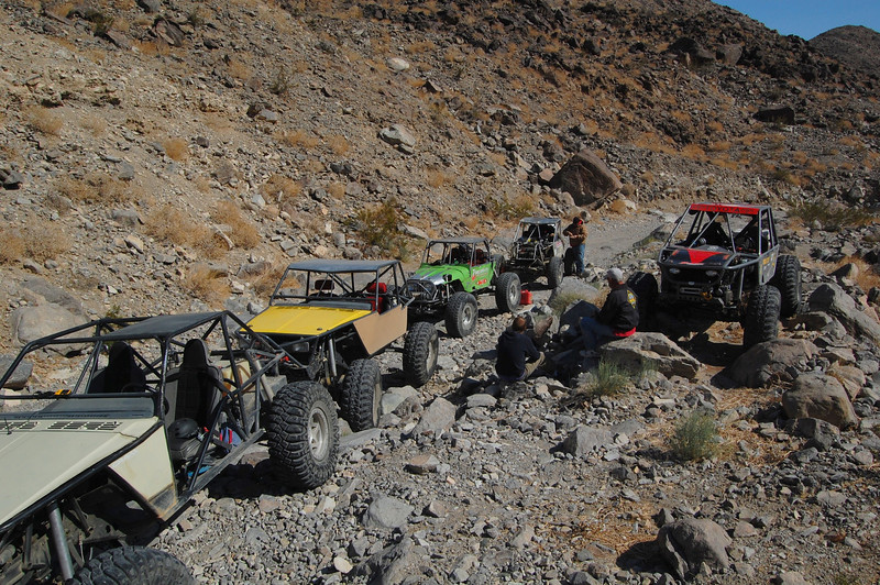

Had another great weekend in the desert. I really like the feel of the new cage work. It just feels more secure. Not sure if it's the taller roof or the
side panels. Speaking of side panels, I need to learn to drive again. At least I made it to the second day before killing one side. Didn't even have time to paint it. Once your use to just dragging the cage along rocks, it's hard to go back.

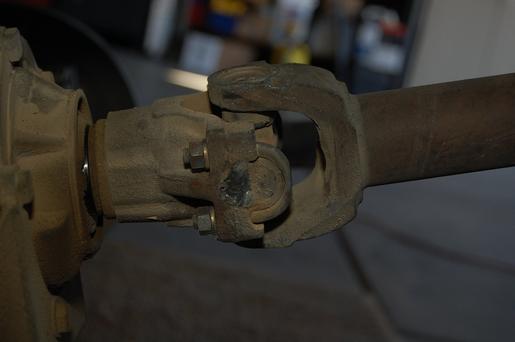

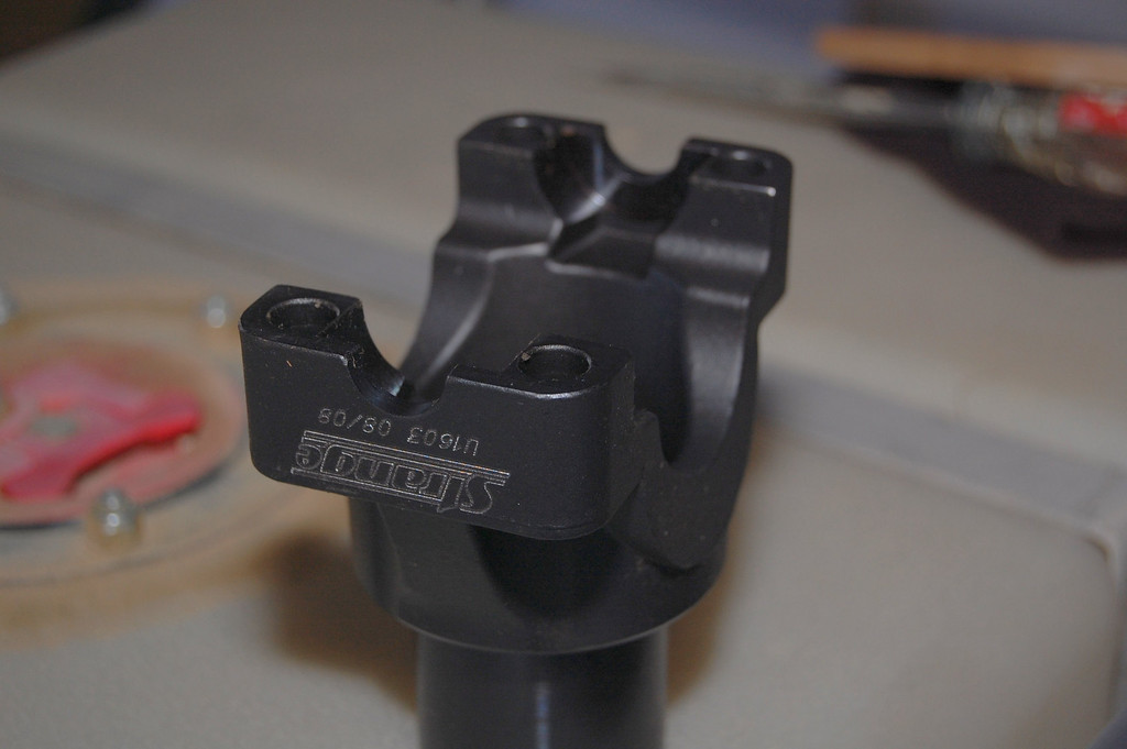

Did some work this weekend. A couple of trips ago the rear yoke let loose.

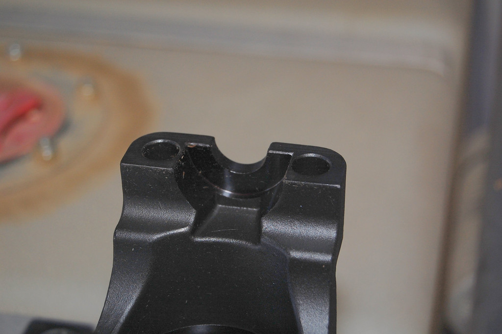

My buddy Andy got out the welder for a nice trail fix. It has held up great since. Thankfully JE REEL drivelines is hooking us up with new driveshafts for the race. Now was the time to go to a larger 1350 joint in the rear. This new Strange yoke has the extra beef.

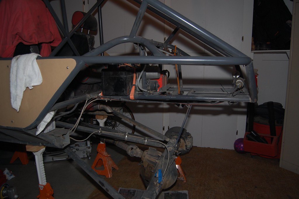

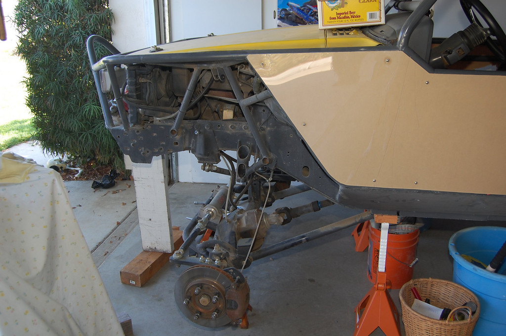

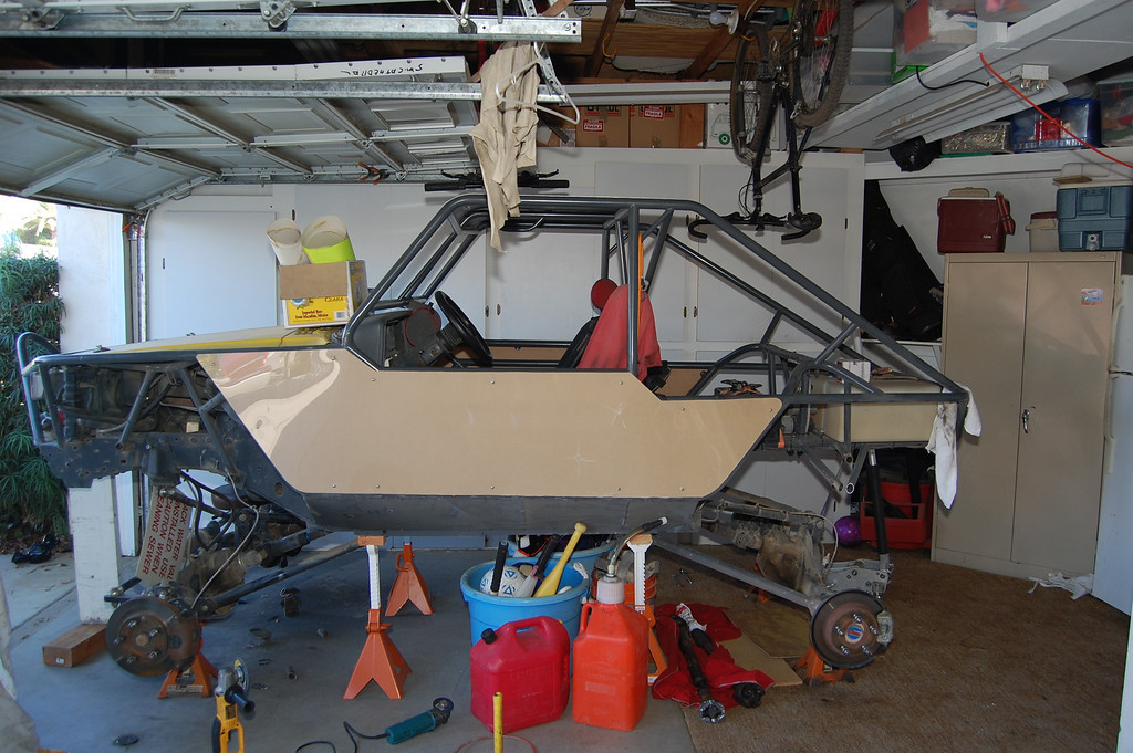

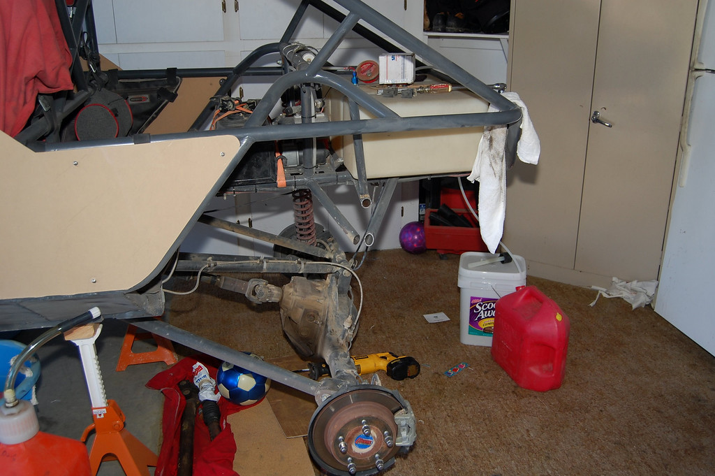

In preparation for the new shocks all the bump mounts needed to get cut off.
It felt good to cut stuff off again. seems like lately I have just been adding. I was going to save all the pieces to weigh but lost interest.
Three of the mounts are gone. I can still taste metal. Thank God for flap disks.All the shocks and bumps are sold. Just have the tires and wheels left.

I'm no mechanic... but can you tell me what you use the soccerball for? I'm trying to imagine a practical use for it. I'm down with the sawzall... just don't see where the balls fit in!

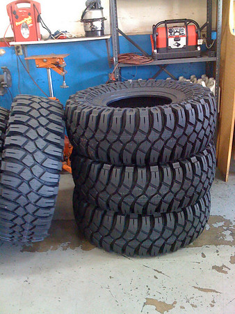

the new maxxis tires are super soft. Really looking forward to running these.
