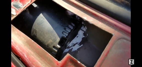

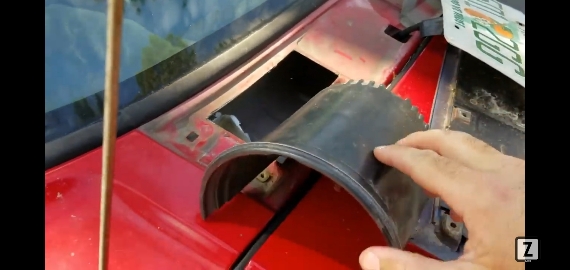

So with this in mind, I think I'm gonna go a different route than everyone I've seen tackle this issue. Im gonna leave the seal around the intake as a last culprit and see if I cant isolate a different point of entry for the water. Im thinking that maybe, somehow, water is not leaking AROUND the seal, but maybe directly into the intake.
And I found a youtube video of a guy that made himself a plastic cover for that intake that still has a hole for air to get in, but covers the intake from above. I'm attaching some pictures of his idea also. So I'm gonna take his idea for a spin and I'll update this post with the results. He went the cutting route I'm trying to stay away from, but I'm pretty confident I can install something similar from the opening on the driver side.
Im also thinking if fabricating a vertical dam to weld into the middle of the cowl that will keep large amounts of water from flooding the intake area when I turn, since I've noticed that I get more water out the vents when I make a hard left. I think the water may actually be puddling enough to overflow into the intake before it has a chance to drain out the sides like its supposed to.

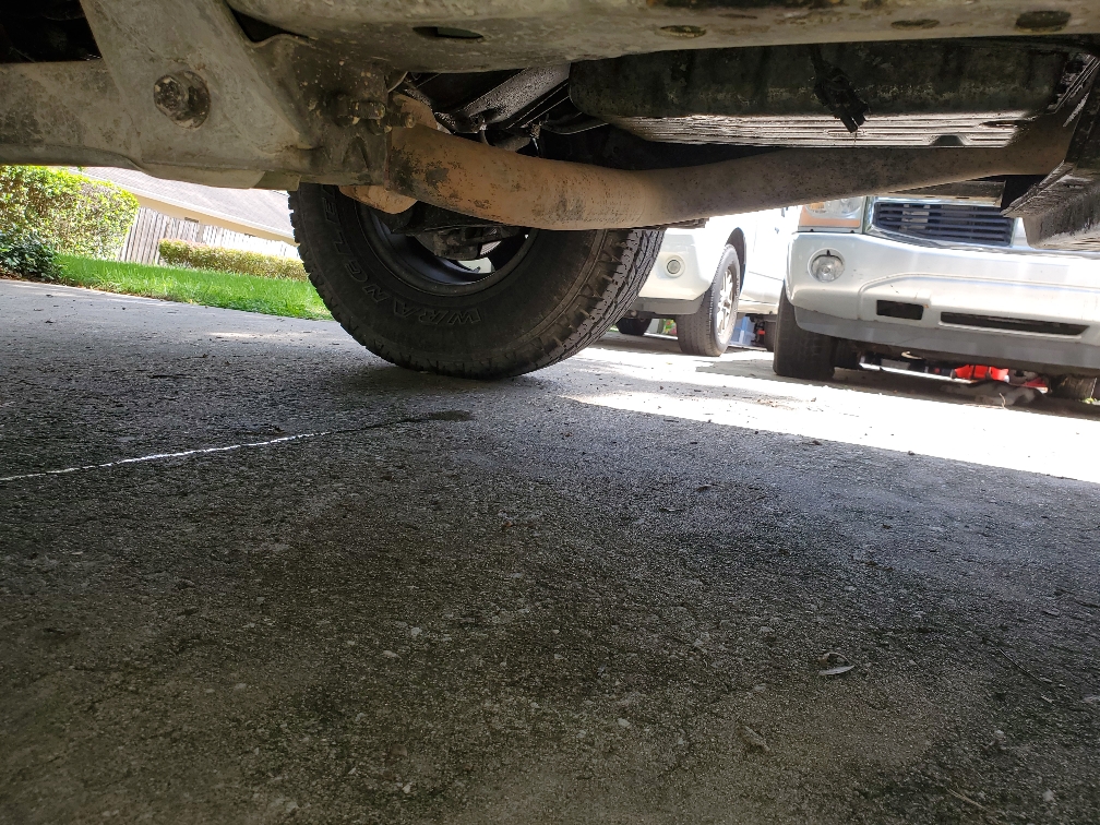

Alright so I'm thinking definitely not the air intake.
Tested this out with the Jeep on a slope towards the driver side and just ran the AC. Today is a perfectly clear day with not a spec of rain and even if it did rain the Jeep spent all night angled away from the passenger side. Just ran my AC for about 20 mins and here's what I get. Water just puring out the driver side footwell vent and not a drip on the passenger side. On some photos you can actually see the condensation dripping down from above.
I also notice that I am getting discharge out of the drain tube but I think for some reason it must not be dripping enough.
With this new info I'm definitely taking out that evap box and checking out what the inside of the drain looks like. Gonna change the heater core and evaporator while I'm there also.
