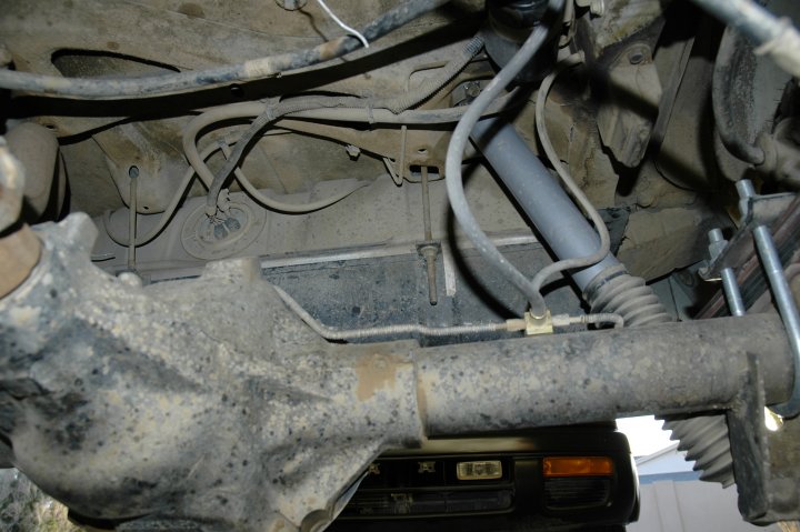

In a 94, the pump is on the rear of the tank and the tank does not need to be dropped. There are two hoses and some wires that have to be disconnected and then you just have to beat the retaining ring around until it lets the pump come free.
This is what you're talking about right? On the front side of the tank where the hoses and retaining ring are. Beat on the ring with a non-sparking object (brass or wood) till it rotates and the pump comes put.
That is it! It also sometimes helps to lift the vehicle from the "frame" to allow the rear axle to droop allowing more hand/arm room to the pump.
