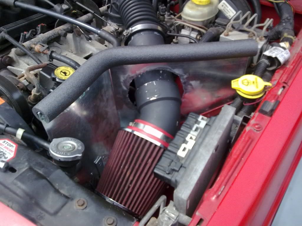

That is why I went back to the cone and thought the Shield would help block some heat and dirt.

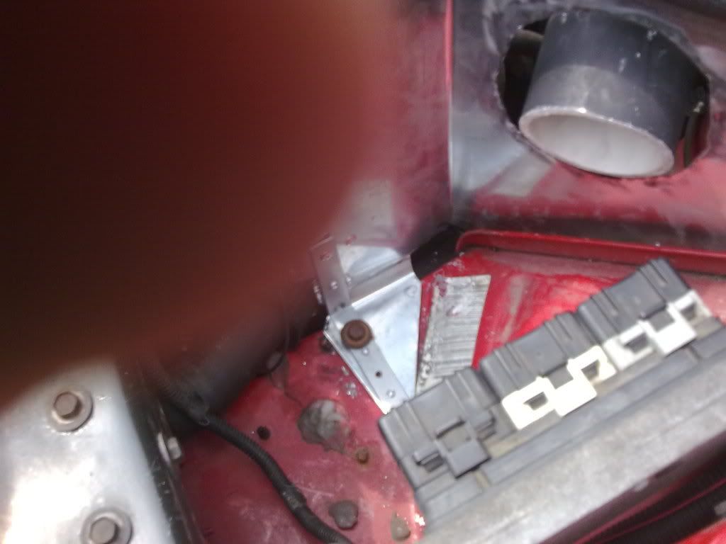

Here are some more pics The paint is on waiting to dry will post more pics when it is all done and installed
http://i844.photobucket.com/albums/ab6/cb1225/intakeshield2.jpg
http://i844.photobucket.com/albums/ab6/cb1225/intakeshieldmount.jpg
http://i844.photobucket.com/albums/ab6/cb1225/intakeshield1.jpg

Drove for about a half an hour to work with the new shield and the filter was much cooler the it normaly is dont know if it feels any better the without the shield. But it has to be taking in cooler just by touch.
Thinking of putting a little scoop over the box to pull cooler air in any imput on this would be cool.
Will post pics of finished product later.:roll:
It makes all the diff like I said the filter feels much cooler after driving It is takin in more cool air when moving. When you let it idol it still gets hot because the shield heats up I will put dyno mat on the outside soon.
If you want the template let me know. If you follow it it comes out good and seals nice.

Well here is the final product the only thing I will change is the seal along the top I ordered a seal kit form K&N Sould be here soon.

For a hack like me this worked out damn good.
