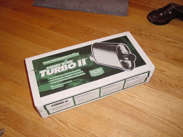

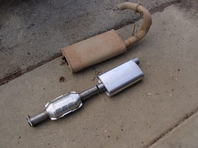

What do yu think about this muffler its cheap and allows more flow, a rock charged the fee at the trail on the muffler
It is not legal to use in a National Forest, or any area which requires a "Spark Arresting" type muffler.herreraxto said:What do yu think about this muffler its cheap and allows more flow, a rock charged the fee at the trail on the muffler
2xtreme said:No, The cherry bomb is not significantly lounder than stock and it is a reasonably deap tone. They hold up VERY well to rocks.

BrettM said:my cherry bomb is loud. I used to run with just a cat and it's 90% as loud as that. I did get the smallest one I could find though, just went behind the counter in Autozone and found the smallest cherry bomb box.
Zuki-Ron said:It is not legal to use in a National Forest, or any area which requires a "Spark Arresting" type muffler.

MudDawg said:If noise is an issue, a cherry bomb WILL get louder as it ages....the fiberglass packing that is between the shell and the straight through perforated core will eventually blow out.....man, them things have been around for AGES...I had hair and all my teeth when I got my first one...and they ARE all but indestructable.
Where did you get one for that price??herreraxto said:I just installed yesterday and the sound its deep and no too loud on idling you barely con hear it from inside the cabin it’s pretty good for the price of 17.99 and the part # is 16804 for 2 ¼
