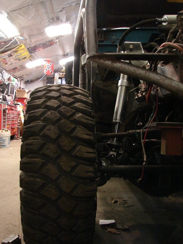

At the time, it was pretty low. The first pic I had shows it at a little over ride height:
I dunno what the actual lift height was, but I had 38.5's and the limiting factor was the inner fender and the stock top shock mount location, for the most part.
With all the crap gone I was able to lower the ride height a little and gain some more uptravel:
