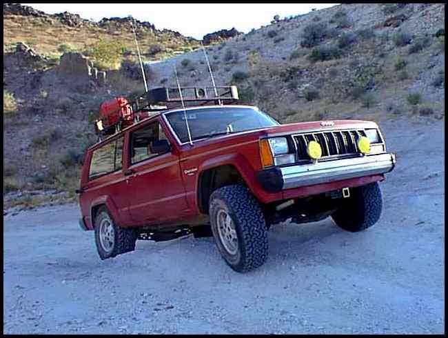

The misalignment of the anti-sway bar links compared to the axle mounts is shown in the proceeding picture. The axle is extended at full droop with the anti-sway bar disconnected. The lower anti-sway bar mount misalignment is about three inches. If the link is attached, the droop will be three to four inches less than shown in the picture (you will loose three to four inches of wheel travel and articulation.)
