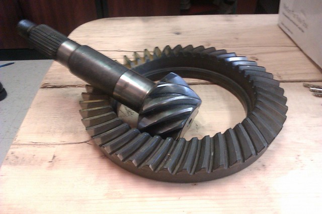

look what came in the mail today :) woot!
