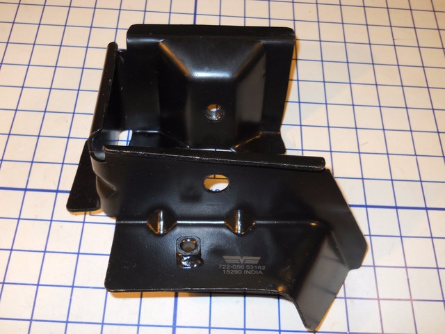

Well this is where I am at now:
Do I cut the thing like this?
271732d1432674832t-front-leaf-spring-bolt-removal-welded-nut-broke-left-spring-eye.jpg
Or is that an aftermarket bracket like this? And not the bolt location for the OEM bracket I have???? 1987 Renix, rear leaf spring, front bolt.
I found the one above, new, on Ebay for about $34 delivered. I need to climb under the beast again and see where the nut actually hides on mine.

I am thinking seriously of just cutting an opening like in the photo, using a lock washer on the nut, Locktite and an open end wrench to hold the nut and slap it all together. Someday, as my knee is getting worse :( Having to dose up with Prednisone till my Doc apt late next week.
Looking at the new aftermarket ones I think there is enough meat there even after cutting an opening, to not need to weld the hole shut or have to add any meat to it? At least for a light duty DD???
